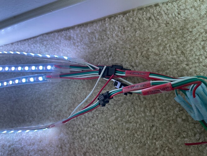

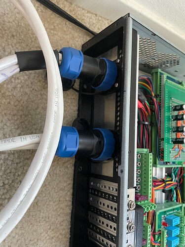

ESTOP - Works great
Override - Works great
Fan with Temperature sensor works amazing !!!
1 1000uf capacitor to each led power side
1 330 Ohm resistor to the DIN control to each Led strip

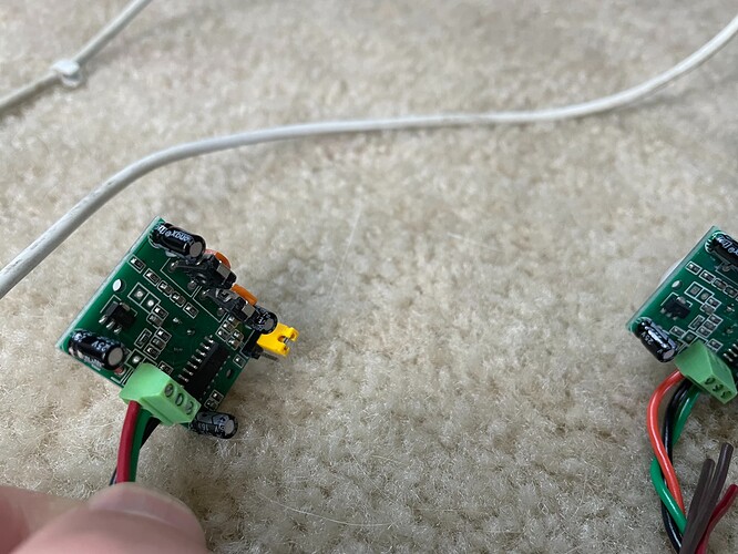

Motion Sensors work and Serial Prints however the leds don't dim up from current values to full intensity. I want them to fade up and back down when motion is detected or not detected.
Also when I am in ESTOP Motion bypasses and turns the LED's white how can I get ESTOP to override all?
Lastly I have noticed that the LED's do weird flickering at startup & Shutdown. What is best practice? do I put a relay in-line on the power for led's and have a delay at startup and power down switch to turn off relays before power off switch is flicked? or is it ok as is?
Thank you in advance for all the help!!!!!
UPDATE: The PRI Motion sensors work sometimes. I have checked all connections and found nothing it has to be with programming.
Normal, you are overriding the PIR readings with an "else if" at the existing temperature. The strange thing is that they work with that code, since one of the temperature conditions will always be met, the code will never pass to the reading of the pir.
You have to rethink the entire "else if" structure of your code. An example: Is that you can never activate the two front PIRs at the same time? Or the two rear ones?
