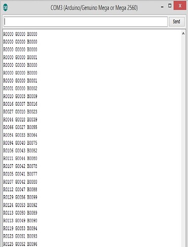

Right now the sensor data changes the NeoPixel strip to the correct color based on the hex data created however, this action is erratic and is not adhering to a pattern of time. Along with this, the sensor is creating false readings in the dark. Without the line of code that controls the LEDs the sensor puts out data readings in a correct constant flow (I am assuming at a rate of 10ms?). At this point my thoughts on solutions for the current code would be to change the rate at which the sensor takes in data to a slower rate. I am assuming that the Arduino is having trouble bouncing between read sensor and light LED and is tripping on itself. At some point I realize that I will have to create code that reads color inputs and directs those readings to two separate iso outputs. Not sure where to go at this point.
Basically I am just looking to see if I am on the right track or if there are any suggestions on how to accomplish this project.
Also, what does "$" mean in this line "if (buffer[0] == '$')". The money sign is not defined in the language section of this site.
If this is relevant here is an example of the ColorPAL reading correctly with the LED code omitted. it is displaying a transition from no object to the introduction of my finger tip.
and here is an image of the readings with the LED code present. Nothing is in front of the ColorPAL

TheZane:
I imagine the dollar sign is a character used by the ColorPal to indicate the beginning of a message.
That is some strange code for communicating with the ColorPal. I don't understand why two instances of software serial were used. Edit: I understand now. The ColorPal has a single I/O pin. One instance is used for tx and one instance is used for rx.
One item that jumps out at me is this:
int delayval = 0; // delay for half a second
I don't know what a delay of zero does, but I imagine your code might not work as expected if you don't give the ColorPal sensor time to generate a new reading.

I have a ColorPAL and some NeoPixels. I've been meaning to try using NeoPixels with an Arduino anyway so I'll probably give your code a try.
Is the main problem the erratic behavior?
Do you think the ColorPAL is giving incorrect data?
DuaneDegn:
Yes to both questions.

Here's my first attempt.
It does some interesting things I think.
The program has a global brightness variable. I have set to one third of the maximum brightness.
If you want to change the brightness level, change the "DEFAULT_BRIGHTNESS" in this section of code.
const int MAX_BRIGHTNESS = 255;
const int DEFAULT_BRIGHTNESS = MAX_BRIGHTNESS / 3;
int brightness = DEFAULT_BRIGHTNESS;
The code scales the brightness from the ColorPal so at least one of the NeoPixels' colors is the full brightness.
It's possible to keep the brightness from being scaled up as it currently is and let you know what to change later.

I changed the baud from 9600 to 115200. I also changed the pin assignments from what you had (they're the same as the original code).
Here's what I have so far.

Thanks Duane! I'll give it a go later this afternoon and let you know what happens.
Just a heads up. The code I posted doesn't appear to compile. I doesn't produce an error message, it the IDE just hangs.
I thought the problem was my PC but I rebooted and it hung again.
I'm trying to fix this. I don't understand what I did to break it.
This is a harder problem to solve than I had original thought it would be.

I think the NeoPixel library doesn't play well with the software serial.
I noticed "delay" statements seems to cause the program to freeze. I switched to a "checkTime" function. Right now the delay is commented out.
Change the code below:
  if (1)//(micros() - lastRead > DELAY_VALUE_US)
to
  if (micros() - lastRead > DELAY_VALUE_US)
and then you could experiment with different delay times in microseconds.
I haven't found any delay times which work well.
I'm not sure what else to try.)

I'm working on a Mega. I came up with this last night. Give it a whirl. Basically the buttons just shovel data over to the NeoPixels. Works really smoothly.

  sprintf(buffer, "R%4.4d G%4.4d B%4.4d", red, grn, blu);
  Serial.println(buffer);
