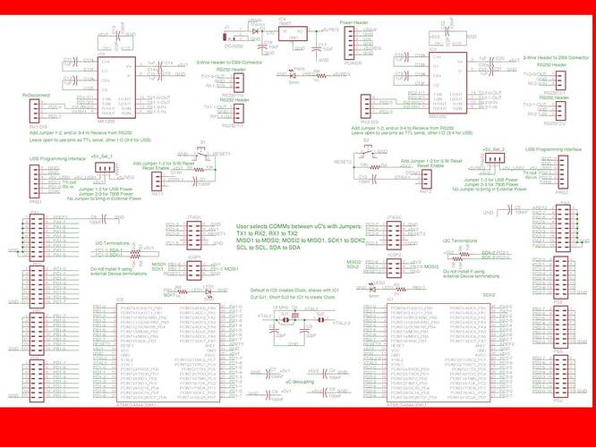

Check it out!
Dual ATMega 1284 (can be 324, 644, 1284)
ICSP Interface each device
JTAG Interface each device
2 RS232 Ports with 3-pin headers to go to DB9 connector for each device - 4 RS232 ports!
Can select via jumper to use port as TTL Serial, or connect to USB/Serial
USB Programmer Header each device
Activity LED each device
+5 Regulator Power on LED
+5 Power selectable for each device - USB Programmer, Regulator, off Board
Reset Enable each device
Reset switch each device
Up to 128K Memory each device
Up to 16K SRAM each device
Up to 4 EEPROM each device
32 IO pins each device, plus Aref, brought to edge connector with Ground pin each device.
Add jumpers from headers to have Serial, SPI, I2C comm's between the devices - Set up Real Dual-Core Processing!
Imagine the possibilities: 12 channels of PWM - 16 channels of Analog inputs - 4 serial ports - 2 SPI ports - 2 I2C ports - what could you make?
All in a handy 80x100mm card with removable processors in case they get damaged.
These screen shots hardly do the design justice!

tow mcus sharing one crystal? I have npt seen this before.

CrossRoads is just showing off his circuit layout skills, while waiting for the pending hurricane. ![]()
Well, I thought I'd build one up & see how it goes!
"The pins XTAL1 and XTAL2 are input and output, respectively, of an inverting amplifier which
can be configured for use as an On-chip Oscillator, as shown in Figure 8-2 on page 32. Either a
quartz crystal or a ceramic resonator may be used."
"This Crystal Oscillator is a full swing oscillator, with rail-to-rail swing on the XTAL2 output. This is
useful for driving other clock inputs and in noisy environments. The current consumption is
higher than the ”Low Power Crystal Oscillator” on page 33. Note that the Full Swing Crystal
Oscillator will only operate for Vcc = 2.7 - 5.5 volts."
I got the idea from an older post where 2 '168s shared a crystal. Gonna put a couple on a breadboard and try it before I order boards to make sure.
I am really happy with the layout. Minimal # of vias, .016-.024-.032" traces throughout, .05" for power. Good user configurability too.
I didn't put an FTDI chip on the board, just the header to connect one to each device.
I figure with CP2102 based USB to serial adapters available for just $2-3 dollars, why put a hard to solder $4.50 FTDI chip on the board that is only used for downloading sketches? Plug on one, or connect via a header cable, unplug & go!
And having some fun, as Lefty recognized 8)
So one mcu drives the crystal to oscillate and the other receives the oscillation? I saw the solder jumper this time.
Nice design Bob: 3 questions
What about some screw holes for mounting?
Are the "top" and "bottom" rows of I/O pins on 0.1 inch centers so that it can be inserted into a proto Board?
If so, Can you put some ground pins inline so that they can be brought onto the proto board?
Thanks

Ok,
Screw holes added on 0.1" grid. Got the 2 rows of edge connectors on 0.1" grid. Added 4 ground hole pads near the end of each row of connectors.
Tweaked traces to let ground plane fill in more. Cleaned up nameplacements.
Any other suggestions? I'm all ears.

Is there enough room to use solder tail sockets on the 232s ?
I believe so. Take a look:
http://www.crossroadsfencing.com/DualATMega1284.brd
right-click, save-target-as, rename to .brd
CrossRoads:
Bob: I can't tell by looking. You board layout and EAGLE skills far exceed mine.
I am just looking at your design as a user. The question I ask myself is "what features would I want". Having the option to socket all of the chips is one of them.
