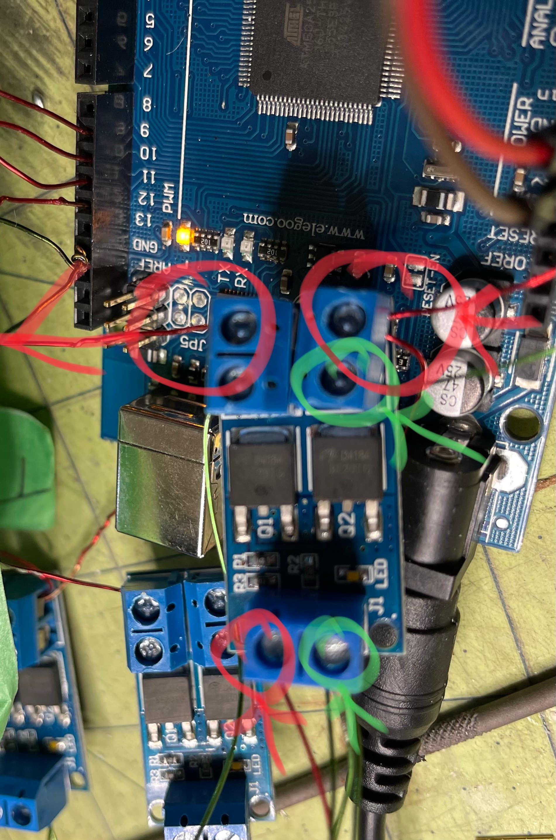

I was just thinking to myself out loud this morning, and I think with using the MOSFETs to supply extra power for the strip lighting I am not going to be able to do the functions that I wanted to do. I don’t think I would be able to have the mega 2560 control the power through the mosfets, will I?
Why not?
Not sufficient pins?
No I think it was a more a case of limited thinking, lack of knowledge on how the MOSFETs actually work. Looking around it sounds like I can control the amount of voltage through the Arduino board that will operate the MOSFET like a dam and based on the amount of voltage going to the MOSFET board will control the amount of power going out from the MOSFET. As far as pins go, there’s 54 on a mega 2560(?), So pins output isn’t an issue, but the PWM’s may be, and if those become an issue, I can use the analogs and get the same results.
It just gets me back now to the same issue:
Anything I have connected to a mosfet is now on all the time without the arduino being on and the arduino does not seem to control anything connected by the mosfets. And there are no ground wires going to the high output side of the connected leds. It’s feels so much like driving around in circles.
So my understanding of how to connect the MOSFET is this:
Arduino pin 2 goes to trig/pwm, gnd goes to arduino ground(?), right side of MOSFET is positive and ground in from other source, left is to the positive of the LED and GRD pin on the arduino. I wired the enterprise so that there is a single ground wire, and then the pin wires i listed in my sketch, but could be way off base as I am still behind the learning curve and didn't get to this part in my digital electronics course for computer repairs. But ends in the lights not being controlled by the arduino, so not sure what I am doing wrong there either. I can plus in my 12 volt power supply and any LED set connected to a MOSFET in any way will be on.
Have you thought of using addressable LEDs like WS2812B or PL9823 for example? With only 1 pin you can control all the LEDs and you can program the color and brightness separately for each individual LED. You might not even need an Arduino Mega, just an Arduino Nano. With them you do not needed MOSFET, just only PSU with enough power.
No, I did not, nor did I even know about those. But I am planning on lighting a Reliant kit, and that will certainly change my ideas on that now, thanks. And that just adds to the level of things that can be called, go to red alert and change all the interior lights to red for example, interesting ideas indeed. Thank you very much.
Those WS2812b’s look very handy for internal lighting, not too sure they will fit into the warp drives but certainly the body/structure would be great. And the strip lights I’ve got in the enterprise are just red for the impulse, blue for the warp drives and white for the hull and saucer sections. And they honestly do look much better than most anything else I’ve seen.
