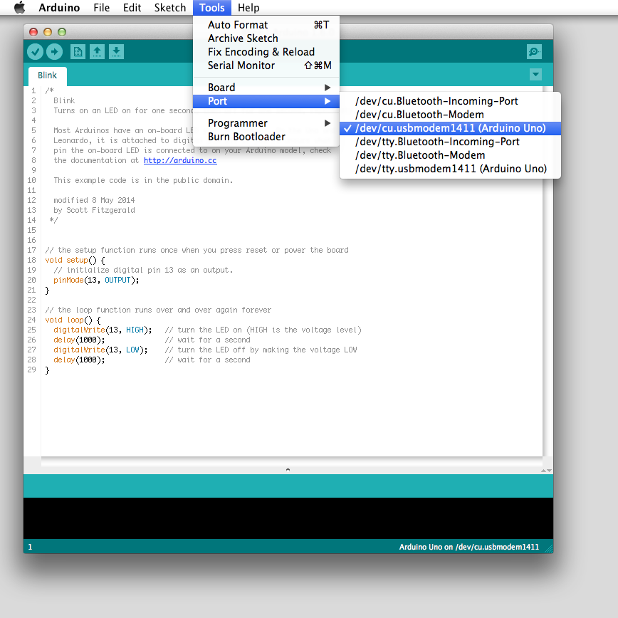

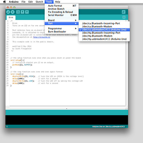

  2. With the desktop I can compile the Blink code but when I try to upload it I get this error,
    "Board at Com 1 not available" Tutorials say to go to "Tools" however there is no Tools menu.
I am running a Mac and the IDE is Arduino 1.8.5

rparry51:
2) With the desktop I can compile the Blink code but when I try to upload it I get this error,
You definitely need to select your boards port from the Tools > Port menu. I assure you this menu does exist, you just need to know where to look for it. I don't use macOS so I can't say where it is.
This looks relevant:
https://forum.arduino.cc/index.php?topic=55567.0
