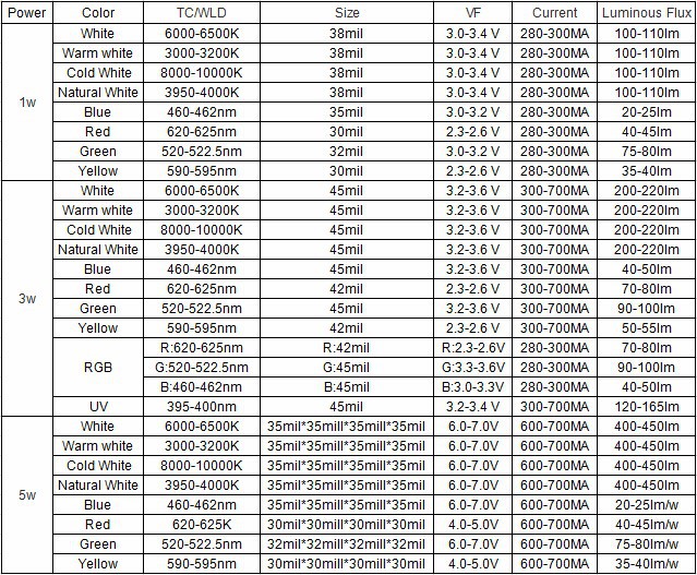

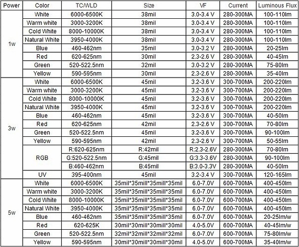

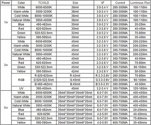

  • I include the datasheet for LED's. I am using 3W Red and Blue leds.

Your chart shows 700mA needed at the most.

Full on all the time, then (12V - (Vf1 + Vf2 + Vf3))/500mA = R
If Vf1 +Vf2 + Vf3 = 8.5V, then
(12 - 8.5)/0.5A = 7 ohm
Watts dissipated by resistor is P = IV, 0.5A * (12V - 8.5) = 1.75W, so use 3W or 5W resistors as they will be warm.
24 strings x 500mA/string = 12A.
At the same time - high power LEDs get warm/hot, and their Vf can change (drop), allowing more current to flow, so most folks would not recommend simple resistor as current limiter in high power situations. Instead constant current drivers are used that adjust the output to keep the current flow constant and prevent the LEDs from going into thermal runaway.
Before going too much further, I would suggest just wiring up 1 string with a resistor and 12V supply and see if it is stable or not, and if you will need heatsinking (or rather, how much heatsinking), to keep things cool.
