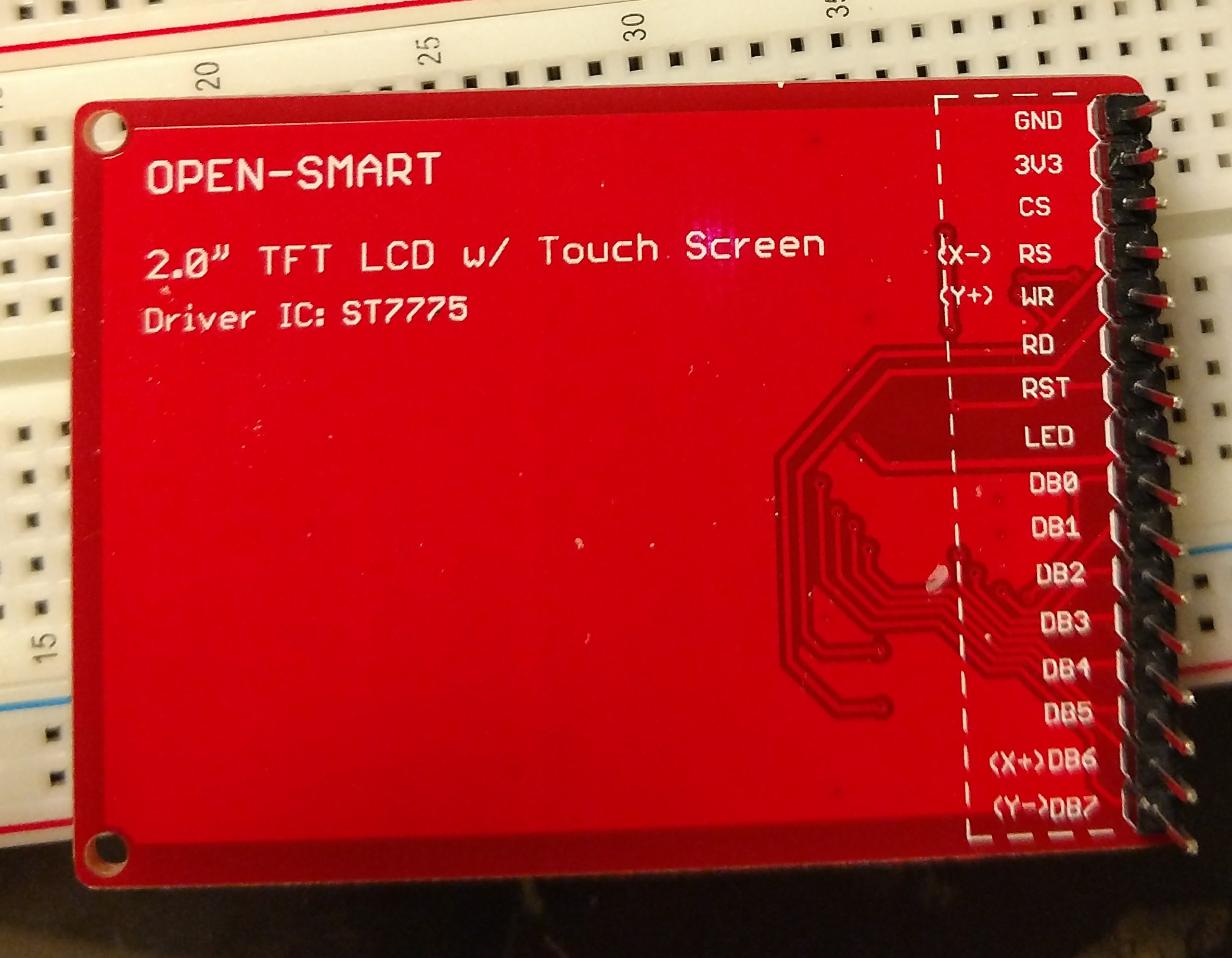

Hey everyone, I'm new to Arduinos and new to circuits in general, looking to get my feet wet here with just wiring up a generic 2.0 TFT lcd touch screen, figured I'd ask for some guidance. I apologize in advance if this is a lot to unpack between my ignorance on the subject, and by all means if these are common or basic enough questions to refer elsewhere that's likewise appreciated, but figured this would be the place to start asking questions.
The part itself just seems to be somewhat generic and I havent been able to come up with any documentation on it. It has the driver IC and pin headers stamped on it (which is as far as my understanding of this really goes). I've tracked down the appropriate libraries, but between that and the part i have in hand, where do I proceed in both the software and hardware side of things? And once completed, how do I verify this (even just by displaying text on the screen)?
Again, being that this is a first project I apologize in advance for my level of ignorance in what I may need. I have a bread board and jumper wires and a basic understanding of how they work, but beyond that really have no idea what I'm doing.

Here we go
Also, to the best of my understanding, would I be trying to connect this to digital pins (as opposed to analogue)? I understand the difference in functionality between the two,, but how do I know what the drivers and part pins are referencing? And how do I go about setting this up?
Sorry again for being such new blood, been trying to understand all I've been able through reference, but the practical application is where it begins to escape me. Thanks!
It is an OPEN-SMART screen with a ST7775 controller. (the clue is in the writing on the pcb)
It is similar to the ILI9225 controller which is supported by the Beta version of the MCUFRIEND_kbv library on GitHub.
These displays are 3.3V so you must use a 3.3V Arduino e.g. Due, Zero, ...
If you are determined to use a 5V Arduino like Uno or Mega, you must use thirteen level shifters.

Thanks, yeah, I was able to figure as much from the PCB, im just so new to everything im not sure what else I'm even looking at from here.
And yeah, I did see that it was a 3.3v display, but also suppose I should've mentioned im using an Arduino clone and the data sheet specifies a 3v3 power pin. Is this just it'd own power pin or does this come into play here?
All Arduinos have a 3.3V power pin. But the GPIO pins on a Uno, Mega2560, Leonardo, ... use 5V logic levels.
You will seriously damage your display if you connect it to 5V logic.

Note that if you had bought a cheap 2.4" Shield, it just plugs in to your Uno. And away you go.
Also note that they will work equally well on a Due, Zero, ...

Go on. The easiest solution is to buy 8MHz Pro Mini (3.3V), Due, Zero, ...
No need to worry about level shifting.
You will find a SPI ILI9225 display on Ebay. It contains a level shifting buffer. And it simply plugs into the Power + Analog Header. (bit-banged SPI). Or you use flying wires to the hardware SPI pins.
