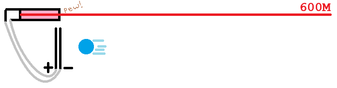

Projectile hits target.
Target vibrates causing plates to connect.
Switch enables LASER.
LASER wirelessly transmits 600M.
Light sensor detects LASER.
Strobe actuates.

A drawing of the idea. When you find a component, put it in the drawing.
