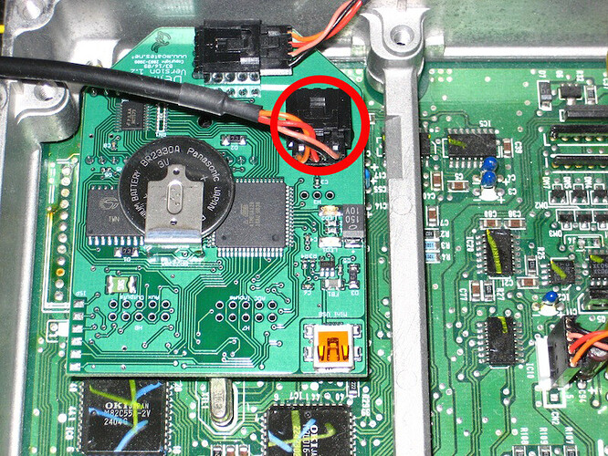

Normally the ecu's CN2 data port is used as described in the last link. On my ecu I have installed an emulator/logging board that occupies that spot for its own purposes, but I discovered that I can add an output header to the board as shown below:
The trick is going to be to figure out the data addresses and baud rate of the emulator board, as they are not the same as the oem ones. I'm confident that the information is out there, I just haven't stumbled on it quite yet.
I've also already added a header to the ADC inputs (H7 at the lower right of the board in the picture), so I will also be able to feed data back to it for logging, or add extra sensors here and there. Should be fun.
