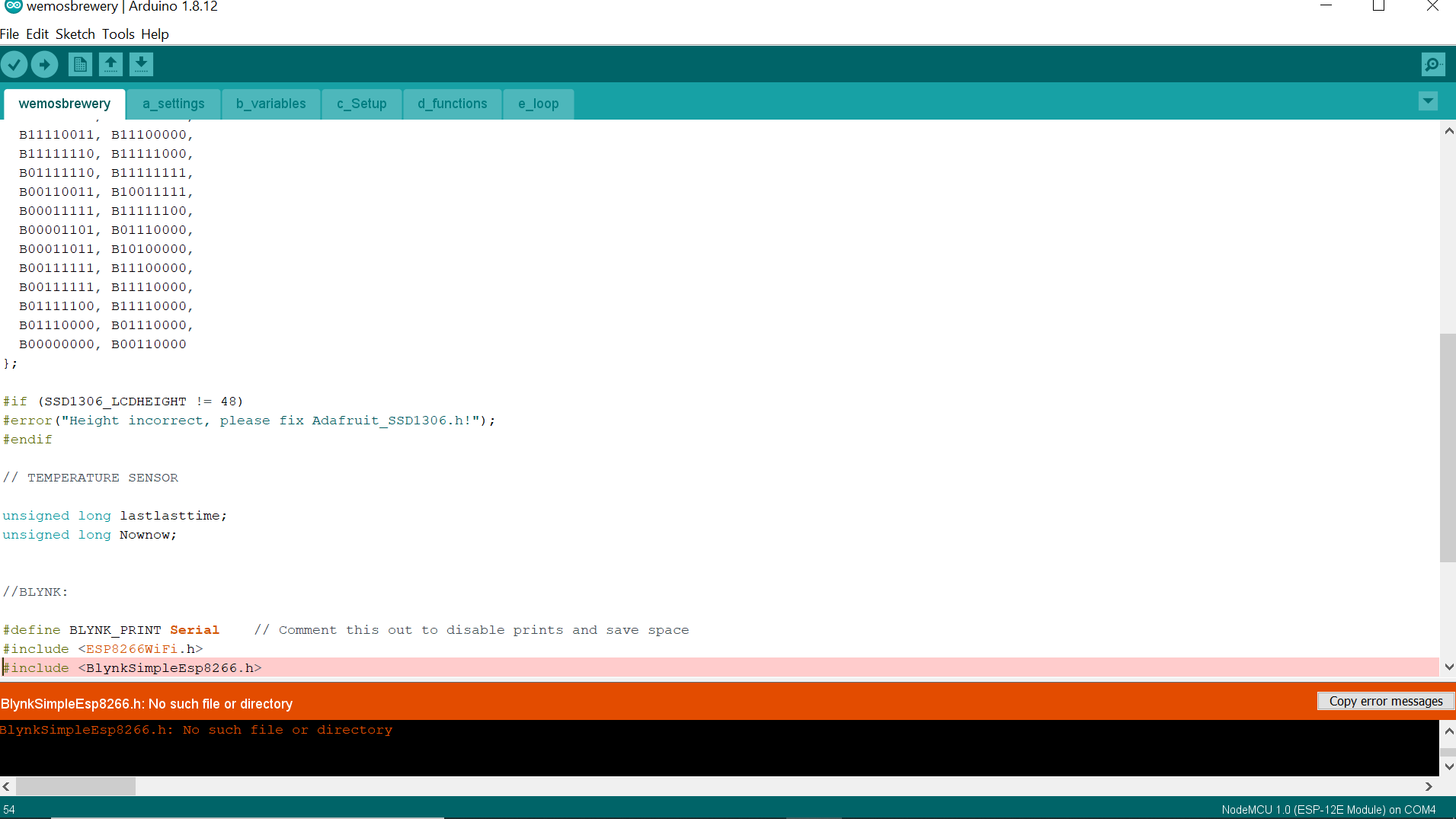

New to ardunio and try to make a home brewing system using ardunio and blynk
i have mangaed all as per the instructions but keep getting a message as per the attached photo, any pointers would be much apprciated.
I am using a uno board and a esp-12e if this is of help
thanks in advance and sorry if in the wrong section.
Don't post screenshots, copy and paste the error text here. There is even a button for the copy part in your screenshot.
I'm new as well, so stupid question, just in case: did you install the library from Tools/Manage Libraries ?
jslovi:
i had a blynk libraries folder in the libraries folder. Move the files to libraries and has now worked
