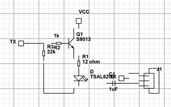

  1. My biggest uncertainty is the transistor frequency. I've read people mentioning that the transistor needs to be around 150MHz. The IR modulation have a frequency of 38kHz so shouldn't anything faster than this be enough for the transistor? The IR transmitter board I'm currently using, uses an S9013 NPN transistor which has a frequency of 140MHz, so is it really needed or totally overkill? The Nano ATmega328 is only 16MHz after all..
  2. Is there a better online eagle viewer than schematics.io? This is the schematics for the IR transmitter board but it's totally messed up.

EDIT: I'll use this schematics. The other one was just to find out what transistor was being used.
Perhaps those people wanted to sound more experienced than they are.
Most common NPN transistors would be fine in that application. You just need to make sure that it can easily handle (at least 2X) the expected current flow and will have low saturation voltage at that current flow (Vce(sat)), about 0.2V ideally.
I would not recommend to use the emitter follower configuration shown. Put the load in the collector circuit.

Aah yeah I forgot to mention that I only used that schematics to find out the transistor they used.
Indeed I will put the load on the collector.

Way overthinking. Almost any general purpose transistor built after 1970 will do it quite well.
If you're so worried about transition times, have a close look at the LED specs.
You should not use a saturated switch to drive an IR power LED.
That makes the transistor slow.
IR power LEDs are best driven by a two-transistor constant current pair.
A 2N2222 or BC337 is the perfect choice for Q1 that drives the LED.
Q2 (the limiter/brake) can be a BC547/548, 2N3904, and many others.
R1 could be about 470 ohm, and R2 must be calculated for the required peak LED current with Ohm's law, knowing it will drop 0.6volt.
That circuit can also drive two LEDs in series on a 5volt supply, for increased range.
Leo..
