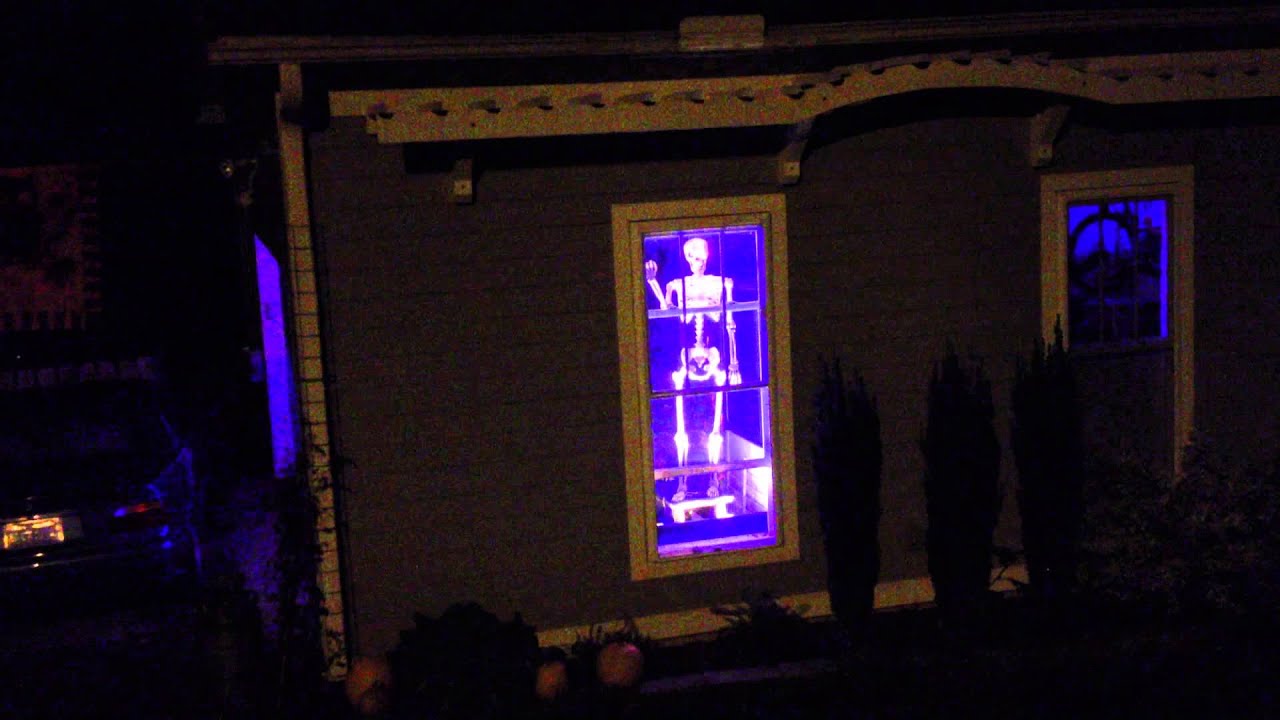

Here's what I did last year with my first Halloween prop. It uses a motion sensor trigger with a special prop controller to light up a skeleton hanging in my garage window. Has some cool sound effects.
