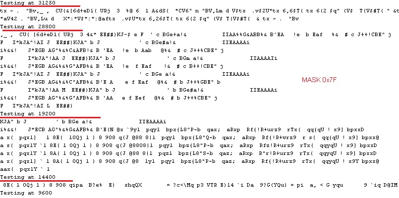

Hello robtillaart,
thanks for quick reply. Neither speeds worked. So I tested them all -
#include <NewSoftSerial.h>
NewSoftSerial mySerial(2, 3);
  Serial.println("Lilypad NSS test");
  long sspd[] = {115200,57600,38400,31250,28800,19200,14400,9600,4800,2400,1200,300};
  for ( int x=0;x <10;x++){
  unsigned long start = millis();
  mySerial.begin(sspd[x]);
  Serial.print("\nTesting at ");
  Serial.println(sspd[x]);
 while (millis() - start < 5000){
    if (mySerial.available()) {
          Serial.print((char)mySerial.read());
  mySerial.end();
  Serial.print("\nEnd of testing.");
Responses I got are puzzling, especially that at 28800 I'm getting some kind of order (I mean NMEA line feeds are at right places).
Ever seen anything like that before?
puzzling indeed .... Great test by the way!
The fact that the line feeds are in the right place might hint that is the right frequency
Can you output in hexadecimal
Optionally mask the value with 0x7F - it looks like they all are high ascii values (just intuition)
Option divide value by 2 (shift one bit) ==> would indicate the startbit is missing/missed

change the loop according to this ...
    char c = mySerial.read() & 0x7F;
    Serial.print(c);
After masking with 0x7F (why and what ...) 19200 looks better. What do you thing about contacting Mikal Hart?
