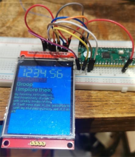

I have tested the TFT_eSPI display library with the HiLetGo 240X320 Resolution 2.8" SPI TFT LCD Display Touch Panel ILI9341 using the following connections
//#define TFT_MISO  16
//#define TFT_MOSI  19
//#define TFT_SCLK  18
//#define TFT_CS   17  // Chip select control pin
//#define TFT_DC   15  // Data Command control pin
//#define TFT_RST  14  // Reset pin (could connect to Arduino RESET pin)
// RP2040 VBUS (5volt) to display VCC if J1 is open
I found this display: https://www.waveshare.com/product/raspberry-pi/boards-kits/raspberry-pi-pico-3/3.5inch-rpi-lcd-f.htm
