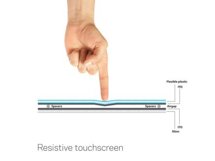

You really need to read the datasheets.
Differences between resistive and capacitance displays:
These displays should be powered with a separate power supply.
blurred screen or flashing screen are symptoms of power shortage which may cause damage to the
display.
These displays are small. That 2.8 inches is the measurement of the diagonal.
That is the diagonal of a 2 inch by 2 inch square.
These are also available on amazon.com.
This display being offered on ebay is strictly a serial port display.
This is NOT i2c or SPI. There is no mention as to the maximum bit rate for the serial port.
I would not choose this display for an UNO.
