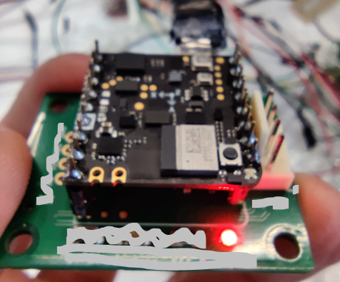

Hi all,
It's my first time posting here. I'm searching for Nicla Vision&Sense Me footprints.
I couldn't find anything yet.
Does someone knows if there any? and if there are any, where can I find them?
Thanks!
Raam.
For the Nicla Vision it's page 16
Nicla Vision Datasheet
You got the width=22.85mm for scale and the pin's pitch is 2.54mm.
Hello,
You are right, but as I got the Nicla I have measured it, and it was a bit different from the specs (in less than a mm) so I have designed it that way, and it worked.
I'm attaching a photo so you can see.
Side note, It was my first time making a footprint so I am sure there is a better way to do it, we are short in time and this solution is just fine.
Best Regards,
Raam
