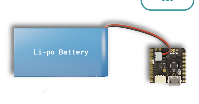

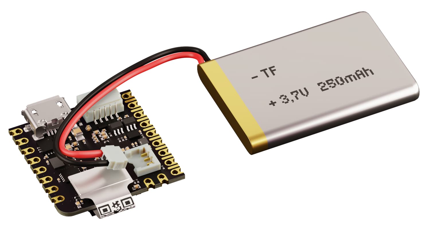

I just fried my Nicla Sense ME board due to a faulty documentation of the battery connectors.
In the datasheet 3v / red is connected to the right pin and GND / black to the left pin. This setup fried my board.
On the support pages the connection image shows the mirrored connection: 3v / red right and GND / black left. This probably works.
Dear Arduino Team: Please update the documentation.

Hi, we are very sorry for the inconvenience and we are working on amend the documentation.
would you mind to open a support ticket here ?
https://www.arduino.cc/en/contact-us/
our support team will take care of your request.
Thanks
Hi Andrea, i already opened a support ticket and got a reply regarding a replacement board. The main thing is that the documentation will now be corrected so no one else will fry their boards.
Hi @emnullfuenf
ok perfect.
yes, the content team is working on to amend ASAP the info.
