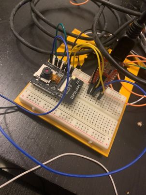

No serial data received esp32-cam fdti programmer
Hey,
I saw these videos Arduino IDE + ESP32 CAM | ESP32-CAM Capture and Send Photos to Telegram | Plus with PIR Sensor - YouTube ESP32 Cam Motion Alert | Send Image to Telegram - YouTube where you made a detection system where you could let a telegram bot send images to you that were detected by your pir-sensor and esp32-cam and i dont know why but i keep getting the same message no serial data received i tried every forum or place with the same problem and nothing worked in the video they use ai thinker i use esp32-cam s version does it matter also they use in arduino ide -> tools programmer many choices but i can only choose esptool how do they get the other options? hope someone can help need this for school
Thank You,
Abdul

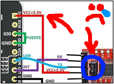

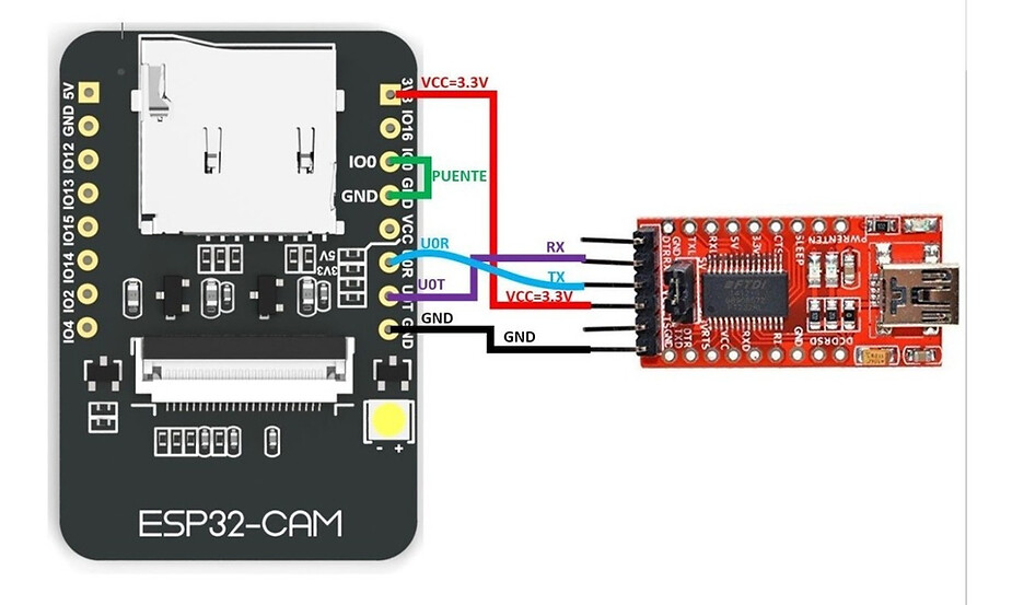

Hi @abdul12345678910.
Did you make the connection between the "IO0" and "GND" pins as shown at this point in the second video?:
https://youtu.be/v36c7-s3jvA?si=5lIO3zU3z-dy4aiH&t=130

No.
Please post a link to the exact timestamp in the video when they use that.
It shouldn't matter. The Tools > Programmer menu selection is only used when you are doing Tools > Burn Bootloader or "Upload Using Programmer". When you're doing a standard "Upload", the Tools > Programmer menu selection is completely ignored. So it makes no difference at all what you have selected from the Tools > Programmer menu.

The diagram shows the jumper on the FTDI module in the 5 V position:
If it is wired this way with the jumper in that position then you exposed the ESP32 microcontroller and other components to 5 V, while they are rated for 3.3 V. This will likely cause permanent damage to the ESP32 and other components, which could definitely be the cause of the upload failure. If so, you will need to replace the damaged ESP32-CAM.

Wait what? What 5v the diagram show they are both connected to 3.3V that's what u meant right? and that failure i got also the first time i used the 3.3 volt if i were to use 5 volt i would have used this diagram
only here i used 5v and this was after many failures with the fdti and my esp32-cam can still light up it's white light when i press the reset button idk if that matters what do u think?

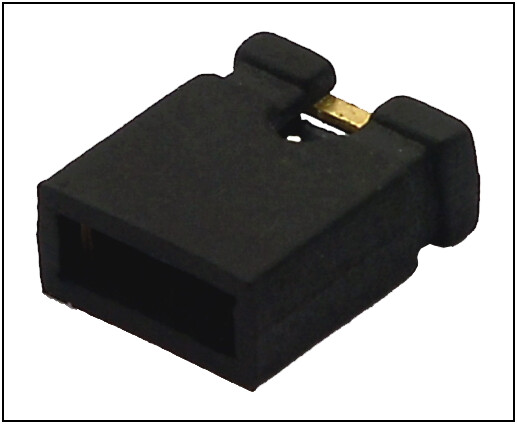

In which position was the voltage selector jumper on the FTDI module? I can't see it in your picture. I'm referring to the thing I circled in blue here:
There are three pins on the voltage selector header. If the jumper is shorting the pin marked "5V" with the central pin of the header, then the module outputs 5 V on the VCC pin and also uses 5 V I/O levels. If the jumper is shorting the pin marked "3.3V" with the central pin of the header, then the module outputs 3.3 V on the VCC pin and also uses 3.3 V I/O levels.
The diagram of the FTDI module connections to the ESP32-CAM shows the "VCC" pin on the FTDI module connected to the "3V3" pin on the ESP32-CAM. They put a "VCC=3.3 V" label next to the "VCC" pin on the FTDI module, but that is only true if the jumper on the voltage selector header on the module is in the 3.3V position. In the picture, the jumper is in the 5V position, in which case the label is incorrect and the VCC pin on the FTDI module is instead outputting 5 V, not 3.3 V.

Also, i didn't know about voltage selector jumper on the FTDI module i am not sure how i can change the vcc between 5v and 3.3v how can i tell what VCC I set it ?
Update i think i know what u mean if i place a jumper on the 5v it gives 5v on the vcc and same for 3.3 but i didnt place any jumper there so it means my computers gives power to my esp32-cam right? Is my cam still fried because of this or are there any other mistakes I should know about before working with a newly ordered esp32-cam?

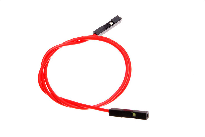

Please connect a jumper between the "3.3V" pin and the center pin on your FTDI module's voltage selector header. The module should have come with a little plastic-encased jumper for this purpose:
If you don't have that jumper, you can use a female to female jumper wire instead. Something like this:

Hey I did it again with the jumper going from 3.3 to the middle pin as u can see
436968118_3355335258100974_9006142980651546329_n
but i got another error `Arduino: 1.8.19 (Windows Store 1.8.57.0) (Windows 10), Board: "ESP32 Dev Module, Disabled, Disabled, Default 4MB with spiffs (1.2MB APP/1.5MB SPIFFS), 240MHz (WiFi/BT), QIO, 80MHz, 4MB (32Mb), 921600, Core 1, Core 1, None, Disabled"

I think I found the problem. On some ESP32-CAM boards, the pin next to the large LED marked "GND" in the diagrams you are using as a reference is not actually a ground pin. My board has this issue and I notice that the pin is labeled "GND/R" instead of just "GND" as shown in your diagrams and other images of ESP32-CAM boards I find online. Contrary to what your diagrams show, if you have one of the non-standard ESP32-CAM boards, you must connect the "GND" pin of the FTDI module to the pin on the ESP32-CAM marked "GND" that is on the other side of the board:
So move that wire and then try uploading again. Hopefully this time it will work.
Hey I did move the that GND wire to the other GND on the other side, but it still didn't work, u think it may be a hardware problem like it came broken when i ordered it? But i am afraid it wil still not work this is for school and is important so i ordered a new one in the meantime but u think getting a wroom version will help the situation?
