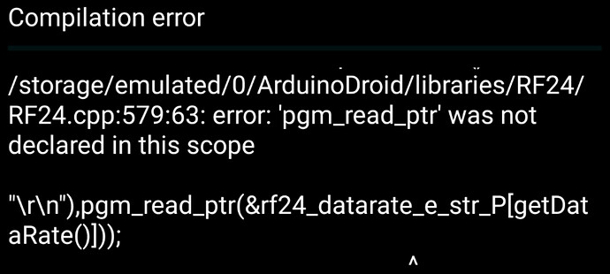

Thanks that solved that error. However I am getting a new errors, and since the app won't let me copy the error text I can't share what the error says (I manually copied the text for the previous error). :frowning:
Actually here you go I took a screenshot of the error :slight_smile:
(Attached below)
