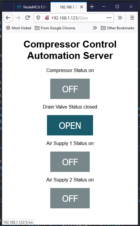

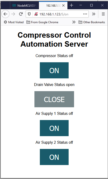

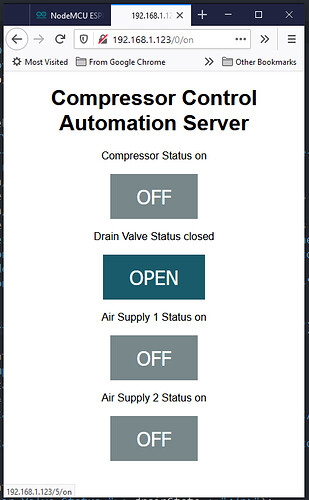

Hello, this is my first project written in the Arduino IDE. The hardware is a NodeMCU ESP8266 board and what I believe to be a knockoff version of the SEEED Relay Shield v3.0. I based most of the code off examples I have found online, but the issue I am having, is this: I need the "drain" button to only stay open for 5 seconds after being triggered. The code below does work, however I have hit a snag which I am not sure how to solve. The while loop runs perfectly and closes the valve after the required time. However, if the web client is left active in a web browser, as soon as the loop finishes, the browser refreshes and send the button command again. This repeats until I manually force the browser to stop or simply close the tab.
If anyone can help me find a way to get this loop to only run once after the web browser button is pushed, it would be sincerely appreciated. Thank you for taking the time to look over my code.
