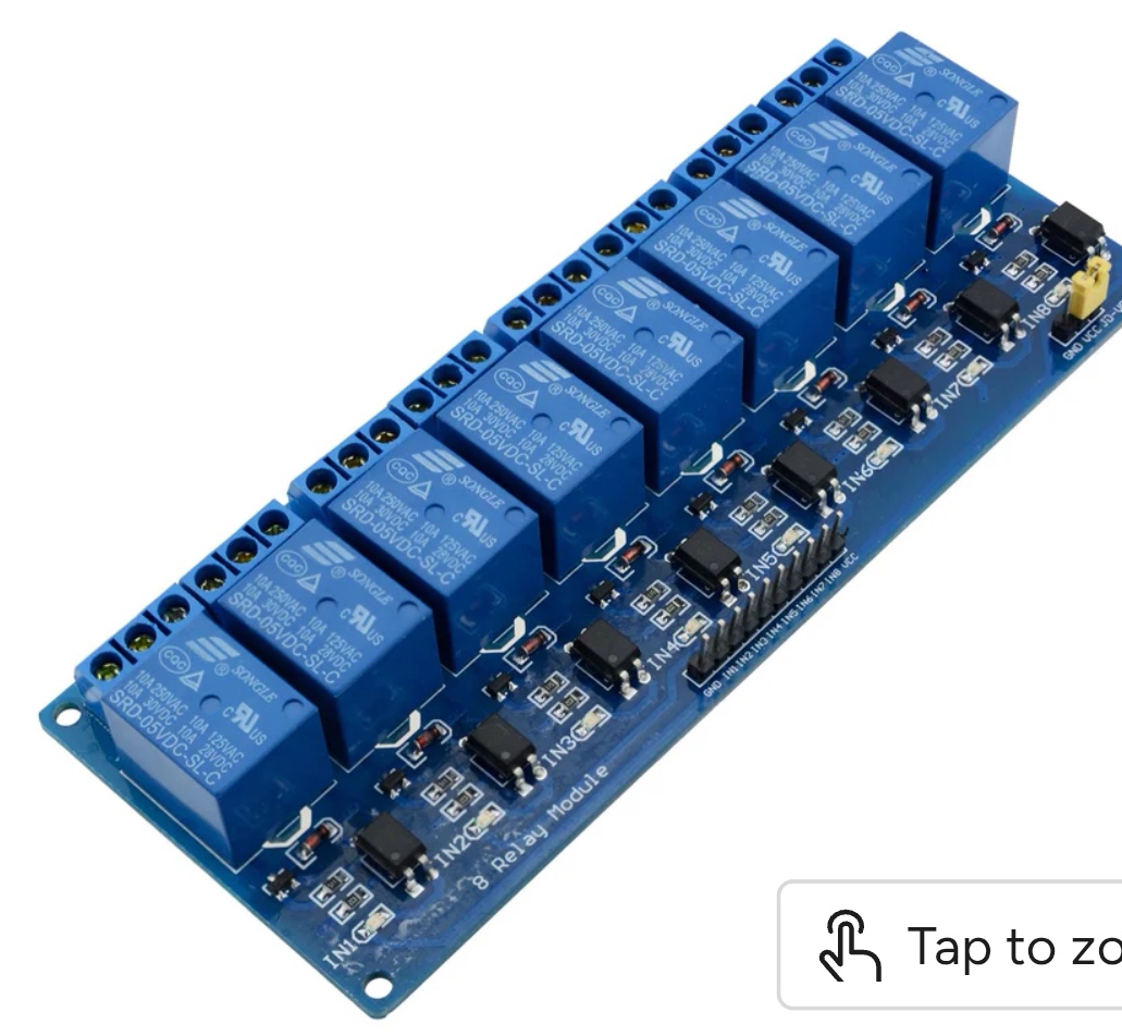

Hi i would like to connect Pzem004t module and 8ch relay board to nodemcu. I am using USB connector for nodemcu which gives me 5v on vv pin but can't control both Pzem004t module and 8ch relay board. For psu i am using 12v which goes to jd-vcc and gnd relay board without jumper on vcc-jdvcc. Also for logic part of relay board I have to use 5v on vcc and gnd to left free. Do you know how to solve this problem?

You need a 5V supply of at least 2 Amps. What is the current rating of your 12V supply?
Your picture shows a 5V relay board, do not connect 12V to it.
On picture is just placed all equipment I have and I asked how to connect them using 12v / 2 A power supply
