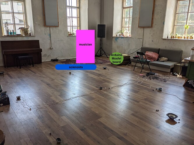

For a installation I'm working on I'm using 8 of those audio amplifier boards.
Each two boards are powered by a 12V 2A power supply using a splitter
each board get is output from a 8 channel outputs audio interface.
Each board is connected to an either 8ohm or 4ohm speaker that I took apart from a found speakers.
The issue I'm having is a lot of noise that get amplified when I'm turning the board potentiometer. Some board has much more noise than other and some very little of noise.
Does someone have an idea what it could be ?

As you say you have no noise when the pot is turned right down, the noise is from the wires that provide the signal to the amps.
Are you using audio shielded cable, like most audio installations do?
Where in your picture are the amplifiers and their pots?
What noise do you get if you disconnect power from the UNO?
Thanks.. Tom.... :smiley: :+1: :coffee: :australia:
From Audio interface to the amplifier board line input I'm using trs cable and from amplifier board to speaker I'm using that RCA cable
I marked it in yellow
I'm afraid I will be able to check it only tomorrow but now when you say that I remembered that when using the amplifier boards without the uno and the mosfets/solenoid boards there was less noise from the amplifiers and speakers.
If the Uno is the reason - anything I can do about? assuming the setup can't be changed location wise.
