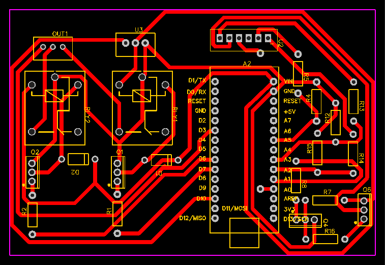

I used arduino nano, and the supply for it come from 12v dc dc converter. Below I attach my connection also pcb.
Yes, it is interference from the motor getting into the Arduino inputs.
You need robust pull up resistors on any input pin try with 1K to start with. Also you need to put a filter network in the motor to minimise the interference.

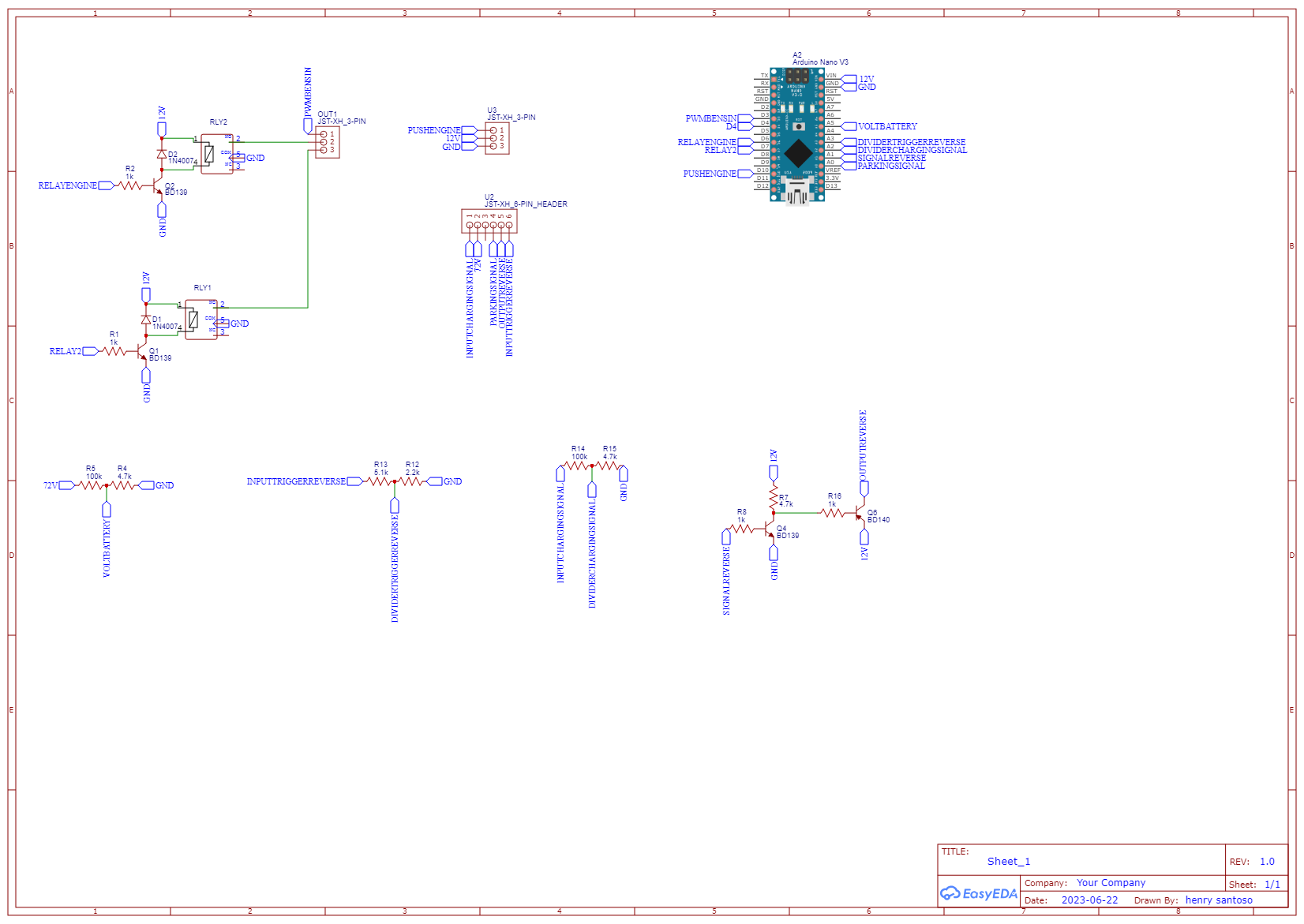

The actual schematic would help as well, and not the game of find the matching label you posted.
It looks like you are not driving the relays correctly as well.
Hi, @Hehenryprbo
Can you please post a proper connected schematic with all the switches and hardware that you have connected.
A PCB schematic is not very helpful to troubleshoot what the external hardware is not shown.
An image of a hand drawn schematic will be fine, include ALL power supplies, component names and pin labels.
Thanks... Tom.. :smiley: :+1: :coffee: :australia:

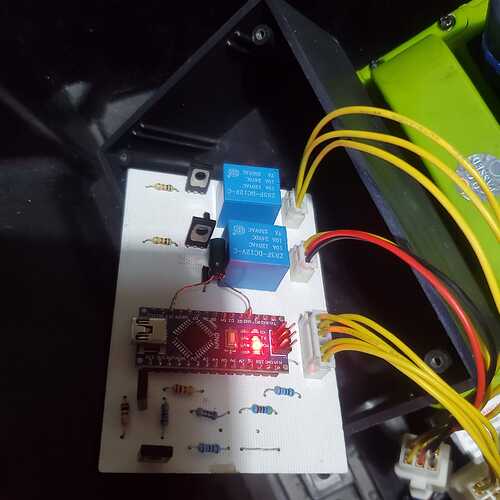

Can you please post some images of your project?
So we can see your component layout.

What does A0 output got to?
A relay, transistor, lamp, LED?
0.1uF cap of any sort, except electrolytic.
Polyester or ceramic will do.
Wire of 1 to 2 metres, they are acting as antenna to any noise from your bike.
A0 output control the parking signal of the votol em100 controller. active LOW.
