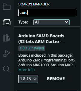

With the little research that I did the board (A-H/E-H versions, I could not find a G-H) seems to act like an Arduino Zero. You will need the drivers for that; did you install the board package?

Did you install the Arduino board package for the Zero?

I installed the package, with the absence of explanation that the package drivers for the LTE were different than those of the MCU.

In case you haven't figured it out yet, below a screenshot of what to install (IDE 2.x, IDE 1.x is a bit different.
This was done. I did everything that was asked. I just cannot figure out why the MCU port is not recognizing the driver port. I don't know, maybe I was sold a defective board.
