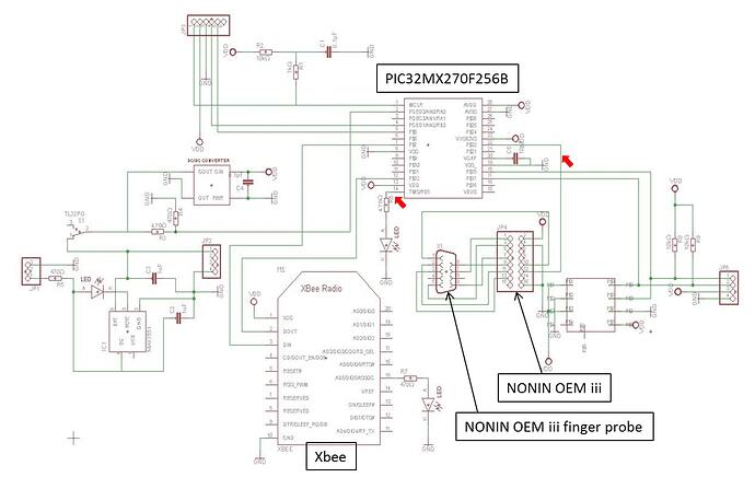

hi, Yes, I have seen this post. The person says,
"I currently have left Pin 08,09,10,13 and 14 un-terminated and hooked up the rest. However, would I potentially need to hook into the serial input in order to start communication with the OEM Board? The data doesn't mention anything about I2C or SPI communication so I'm not totally sure how to go about hooking this up..."
1.Is the person using only the OEM chip from page 10 in the specs sheet or the whole board like in the picture?
  1. the pins in page 10 are labelled at j1-01 and so on. What does J1 indicate here?
check the image. Much thanks for the help!

The reddit article used software serial to read the serial output of the OEM.
You use resistors on J1 pin 9 to select the serial information format.
Their is no SPI or I2C comms.
You do not have to send any comms to the OEM, it just blurts it out data on its own.
Tom... :slight_smile:

I am so lost. I know that this is a lot to ask, I have just started learning about serial comm. Can you guide with the pin connections between the OEM chip and arduino?
Check the image I have attached. Do i have to do something like this?
Well?
Can someone guide me with the steps? Can i directly connect the ground from the OEM evaluation board to the arduino ground and the serial outout pin from the board to Rx on arduino? I did see the other forum thread with paulS describing the coding, But they have connected the OEM chip and sensor to arduino and have not used the evaluation board.
