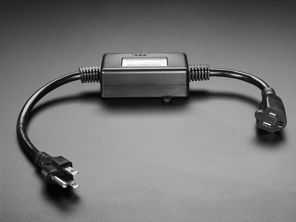

For your safety and the safety of the Arduino and your computer (when your computer is connected to the Arudino) you MUST ELECTRICALLY ISOLATE the Arduino from the lethal voltages!
If you want to turn a 120VAC device on & off from the Arduino the easiest & safest solution is [u]this[/u].*
Or you can use a relay, which is an electrically-isolated, electrically-operated switch. The Arduino can't directly drive a regular electro-mechanical relay so you need a driver circuit, but you can buy relay boards with a built-in driver.
There are solid state relays that can be controlled directly from the Arduino. Industrial type solid state relays like [u]this[/u] are super-easy to wire-up with screw terminals (and easy to mount).
The coil/control specs for a relay are "exact". That is, if it has a 12V coil it must be controlled with 12V. The contact ratings are the maximum, so for example it's OK to use a 240V / 10A relay to switch 120V / 1A.
Solid state relays are a little more tricky on the switched side. AC & DC relays are not interchangeable and sometimes there is a minimum voltage rating (as well as maximum ratings).
  • I assume it has a solid state relay inside.

With the Arduino, you can easily control a ‘Power Switch Tail’ product, it then controls your 120VAC device.
Anything more than this, my guess, you are not ready to handle.
