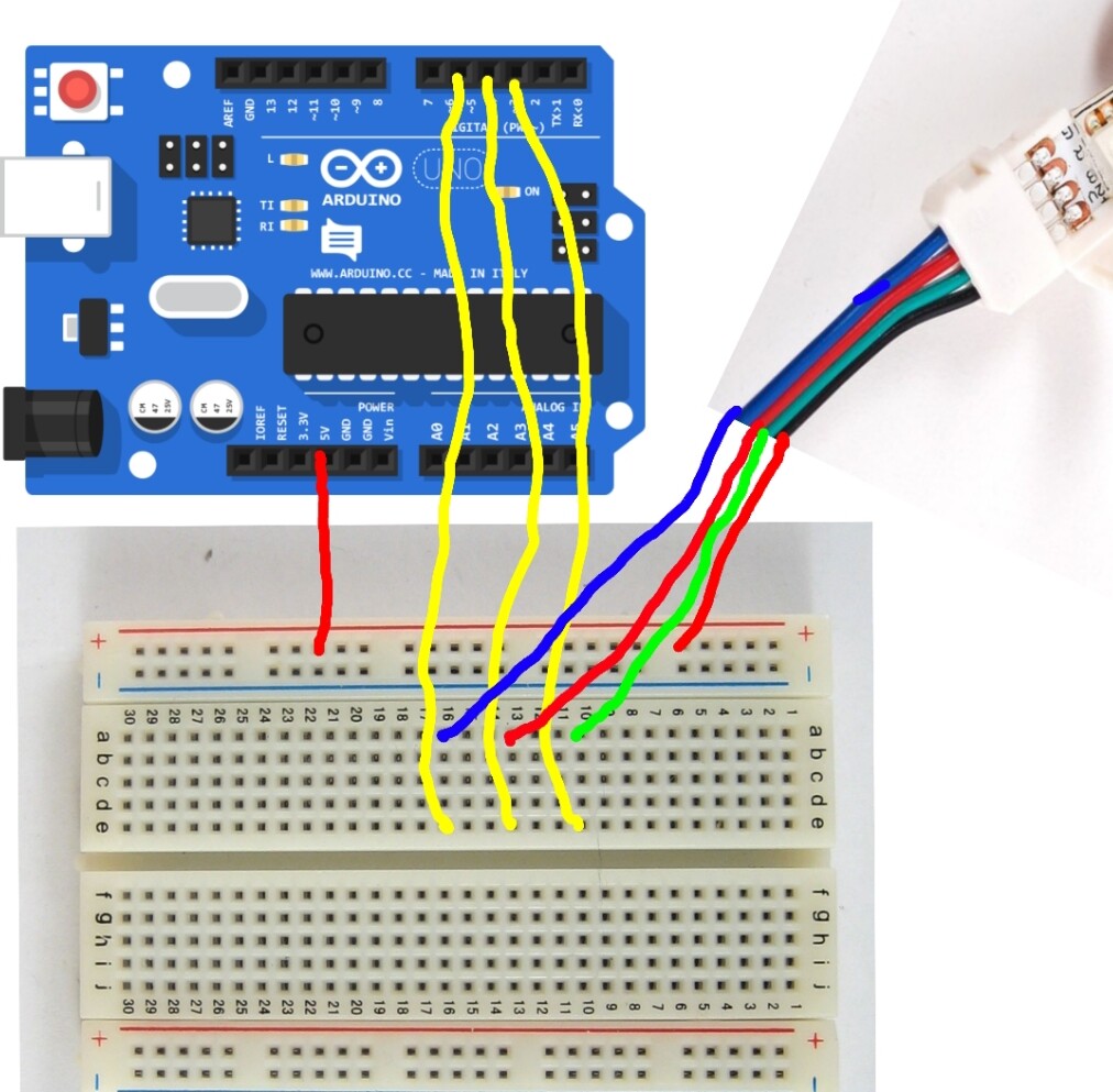

I recently purchased a super cheap LED strip from walmart. I never got around to using it for its intended purpose so I decided to hook it up to my arduino to see what I can do with it (Im more of a code guy than electronics). I looked at the strip and Saw 5V, R,B,G. When I wired everything I ran the 5V from the 5V out on the Arduino to the power strip on my bread board, RBG to their own rows, then linked each of the rows to the power row (initially confused the G as ground but thats neither here nor there). Long story short it worked. I wrote up some quick code (by copying and pasting lol) and in a few moments the led strip was blinking and changing colors...AWESOME. I got bored of that quickly and started to take it apart when i realized something....I never ran a ground. Since no ground was run, should it have worked?? Im kind of confused as to how it worked without grounding. Was the ground necessary? What negative impact would I have with this configuration (burnt LED, blown board, apocalypse?)

Not as to anything to do with grounds as such, but the suspicion that you have connected Arduino pins directly to the LED strip.
We need you to detail how many LEDs and what resistors are on the strips? You cannot use an Arduino pin to either supply or ground more than 30 mA.

10W at 5V equals 2A; you can't get that out of the 5V pin of the Arduino.
that's where I'm confused......why did it work? There was no ground and per this thread I shouldn't have been able to get the power I needed yet there I was with an LED strip cycling from red to blue to green in a lovely rhythmic fashion. Was it just a matter of time before the arduino gave out? Was the LED strip on but just not operating optimally?

We would really need to see an image of the wiring to determine the ‘why’.
Yes, that's the point. So far we have no idea of what you actually did. Our guess is that you wired Arduino pins to the LED strip, but your description is not really clear at all.
Take your arrangement out in daylight and take a picture of it for us please. Quicker than trying to put it in words :grinning:

Fair enough. Does this help?

Yes, that makes it clear. Not the way to do it - you need driver (MOS)FETs (and these days, we don't use "bipolar" transistors because the FETs just do the job properly) to switch each of the three lines to ground.
You want to know how much current the strips draw, generally 20 mA per LED, but if you use generously rated "logic level" FETs, you should be fine.
