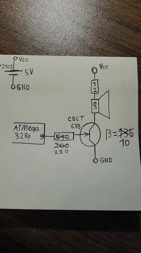

I'm experiencing troubles with using a speaker (8ohm 0,5W) in my project. Firstly, i followed tutorial on wiring ATMega328p on breadboard to make it work as arduino uno (https://www.arduino.cc/en/Tutorial/ArduinoToBreadboard). I can tell it works flawlessly for me. It's powered by CP2102 USB Bridge (https://www.silabs.com/documents/public/data-sheets/CP2102-9.pdf).
Then i added SD card module (to the SPI pins 11,12,13, and CS pin to pin 10 of Atmega), and made pin 9 a signal pin. To make my speaker louder, i tried wiring transistor to circuit (CBCT639 NPN) (simple scheme attached).
I want speaker to use max power, so I need to put 2V on it (am I thinking in the right way?). By using voltage divider calculator I concluded that i need to put 12ohm resistor before it. Then i used transistor base resistor calculator. Since i just want to amplify the signal from pin 9 I assume hfe=10 as i found recommended on Internet, so it said I need 200 ohm resistor (I used 220 ohm).
After putting it all together it doesn't work as expected. I checked with electricity meter, and I only get only 0.75 V on speaker and only 90mA going through it. I tried playing simple notes without SD module and i get simmilar results. I also checked current going from signal pin and it's 7 mA (but it's 50% duty cycle so maybe it's actually 14mA, but still, with 220 ohm resistor there shall be going 23mA). The max current of CP2102 is 500mA, so it's not the lead.

That's not how you amplify a signal to drive a speaker. You have DC passing through your speaker all the time, this is not good.
Search for a class D audio amplifier, you should be able to get one for about £2.50 or something, that will do what you want.
Not that it matters much but I could not find a datasheet for a CBCT638 and the symbol you have drawn is for a uni-junction transistor (sort of), which won't amplify audio.

I suspect two issues...
I assume you know TMRpcm is actually PWM? It's not analog either.
1. A multimeter won't give accurate measurements with PWM so I don't trust your voltage & current measurements.
2. The voltage drop across the transistor (VCE when on) is probably higher than you expect.
Test it briefly with a DC voltage by writing a digital "1" (high).
Unfiltered PWM can do "nasty things" to an amplifier so you can try it, but I wouldn't connect my hi-fi amplifier.
If you're going to use PWM, I'd stick with the single-transistor method unless you need a volume control. If you need more volume you can take-out the resistor and/or increase the voltage as long as the speaker & transistor can handle the current. And make sure the transistor is off when you're not playing sound so you don't send constant-DC through the speaker.

Exactly! The voltage drop on transistor is quite big. While speaker is playing normally the voltage drop on transistor is about 1.5V. While testing it with digital 1 it reached 4,5V and speaker had 0.1 V as current at base resistor was 0.1mA. When I tested it with digital 0 no current was present as it shall be.

Yes, it doesn't work. There's no way it could since arduino pin gives PWM signal. But let me specify. I did not ask on how to make a signal filter, becasue as you said I can google that for myself. I just don't understand why I can't get 250mA going through speaker. It's something about transistor, but I don't know what. I even tried wiring it someday without resistors (i know stupid), which should technically destroy arduino pin and, but even then current didn't reach 250mA.
Well, actually maybe my electronic meter is that bad, that my measurements are very insignificant, I am afraid that it may be the other option.
You realize you can't measure current though a speaker that is being driven by PWM don't you ?
(for obvious reasons: the current is not constant).
In fact , I don't see how any current measurements you have taken could possibly be valid.
If it's volume you want then just use an LM386 audio amplifier chip.
