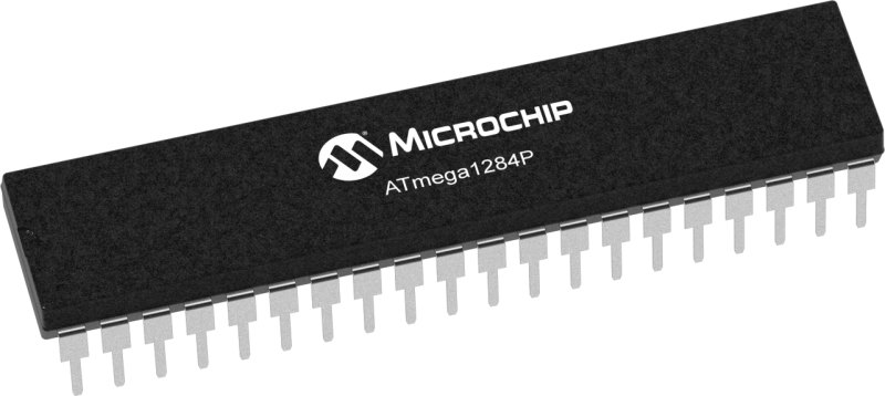

Ok, thanks.
After some researched maybe ATmega1284P ? Its compatible with arduino and have bootloader
First I will try with Atmega 32u4
Maybe 0,5kb more will be ok
