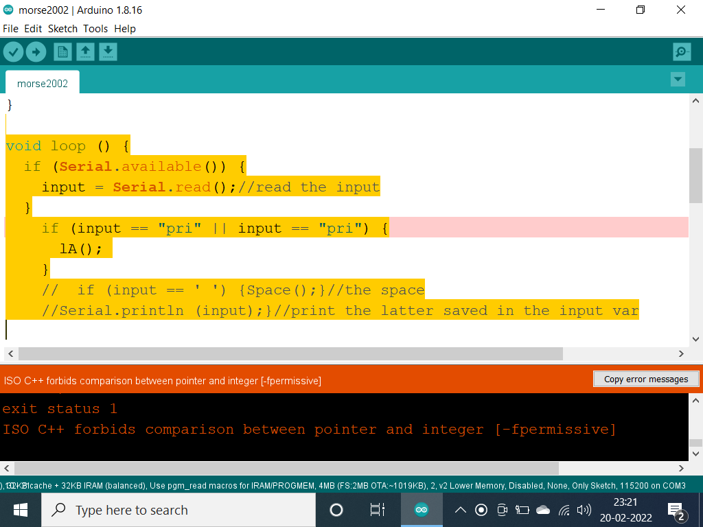

i corrected but nothing happens with led when i input in serial port. the following is the code

Single quotes, single character.
Serial.read returns a single character.
how to code for strings pls
You are trying to compare a single character to a String.
Single characters go in single quotes.
Please stop posting pictures.
See Serial input basics - updated
