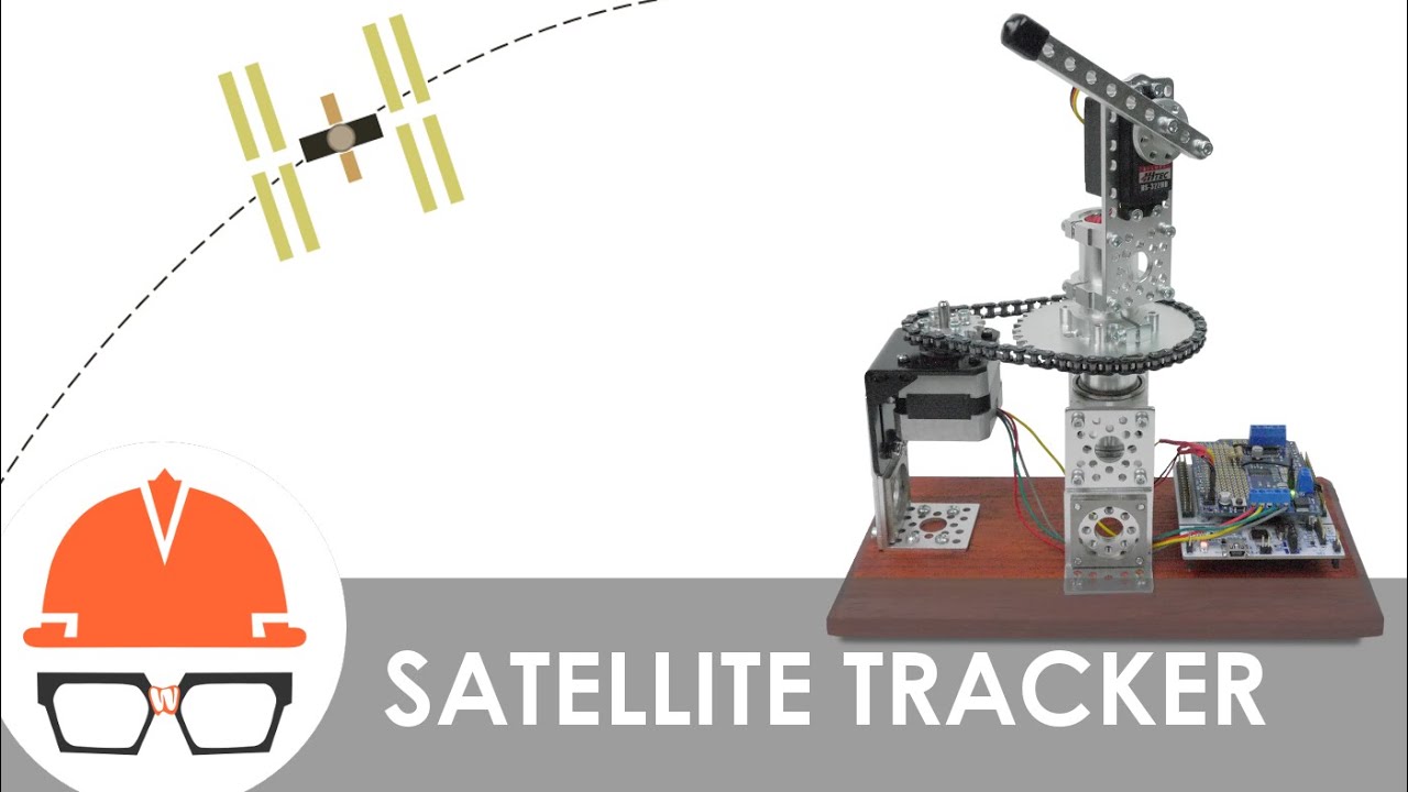

ok, context.
Most of the code is not my own and I'll explain why.
I spotted this project on YouTube and it looked an interesting challenge.
Although the YouTube project uses an ST microcontroller I had trouble making that work, so I bought and Arduino Due, similar specs.1
The article gives a reference to the source code in GitHub.
I had some trouble with the include statements, so I opted to port blocks of code as the compiler needed them.
In the original code, the time is manually entered (seconds past 1/1/1970) with a cryptic note to make it smarter, so I did. I purchased a Duinotech GPS module and wrote some supporting code which works well.
The code uses the processors RTC to keep track of elapsed time, so I tried doing the same thing and used the RTCDue library. I seem to have succeeded, but have a secondary issue that the Arduino things there are multiple libraries of RTCDue, I'm trying sort things out. The compiler makes a choice of which library to use and after fixing a few things in the library I am now faced with what I think is a linker error as the error message does not mention and source code, just a library.
As I said, I'm not sure what to do, but I'll try and resolve the multiple library instance first and see what eventuates.
In desperation I installed the Arduino IDE on anther computer and tried compiling the source code and now have a different error in that it complains it cant find RTDue.h in some subfolder. I'll leave that and work on the original computer.
Hope this helps in some way.
