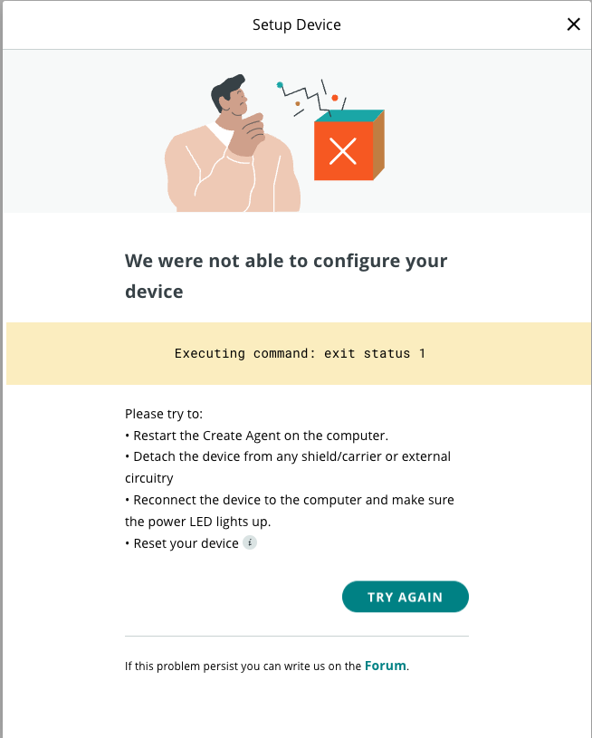

I've attached many screenshots showing some of the errors which I am getting.
well, some of them, after restarting the dozens of failing steps I'm unable to even get the board to configure so I included that screenshot.

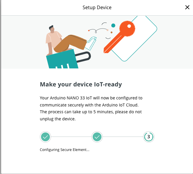

Even when it's not losing power it manages to get stuck on random steps for far longer than it reasonably should, such as on the third step of device configuration for IOT.
In this case it then just gave up and said that no board could be detected?? even though it had already detected it, and uploaded the base sketch??

As for the debug console, it does appear perfectly fine, however drops the serial connection for a cycle when it reaches the error if I remember correctly.
*for some reason it decided to work first try to configure and upload and I'm too scared to reset it so this is just a screenshot of the fact that it can definitely be recognised by the create agent. I'll reply to this when I next try to upload something and get the errors again.

This screenshot shows the create agent debug console around and including the time that the exit status 1 appears.
