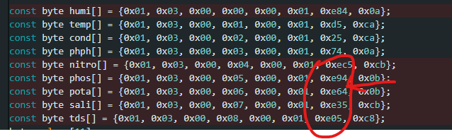

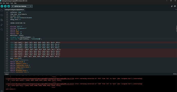

Does anyone know about the issue, when I enter a 3-digit number after '0x' there is an error during verification, and when I only enter a 2-digit number, it can be verified correctly, but since this is for calibrating an NPK sensor, the numbers will be all over the place, is there a solution?

#include "WiFi.h"
#include "ThingSpeak.h"
#define RE 4
#define RXD2 17
#define TXD2 16
WiFiClient client;
unsigned long myChannelNumber = 1;
const char * myWriteAPIKey = "Put in your API key here";
const byte humi[] = {0x01, 0x03, 0x00, 0x00, 0x00, 0x01, 0xe84, 0x0a};
const byte temp[] = {0x01, 0x03, 0x00, 0x01, 0x00, 0x01, 0xd5, 0xca};
const byte cond[] = {0x01, 0x03, 0x00, 0x02, 0x00, 0x01, 0x25, 0xca};
const byte phph[] = {0x01, 0x03, 0x00, 0x03, 0x00, 0x01, 0x74, 0x0a};
const byte nitro[] = {0x01, 0x03, 0x00, 0x04, 0x00, 0x01, 0xec5, 0xcb};
const byte phos[] = {0x01, 0x03, 0x00, 0x05, 0x00, 0x01, 0xe94, 0x0b};
const byte pota[] = {0x01, 0x03, 0x00, 0x06, 0x00, 0x01, 0xe64, 0x0b};
const byte sali[] = {0x01, 0x03, 0x00, 0x07, 0x00, 0x01, 0xe35, 0xcb};
const byte tds[] = {0x01, 0x03, 0x00, 0x08, 0x00, 0x01, 0xe05, 0xc8};
byte values[11];

The datatype of the arrays is byte.
A byte can only be between 0x00 and 0xFF.
Why do you think that the calibration values need to have 3 hexadecimal digits?
How is the calibration done?
i got the codes from :
7 in 1 Soil Monitor : 6 Steps - Instructables
0xc5 would be correct, just remove e from all of those.

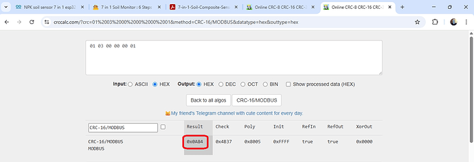

From the Soil Sensor Manual:
The last two bytes are a Cyclic Redundancy Check of the first 6 bytes, with the least significant byte first.
There is a an online CRC calculator at:
CRC - 01 03 00 00 00 01
The result is shown as 0x0A84.
The least significant byte is sent first, so the last two bytes become 0x84 0x0A.
Thus we get:
const byte humi[] = {0x01, 0x03, 0x00, 0x00, 0x00, 0x01, 0x84, 0x0a};
I've filled in the data for you for the other ones in the following links:
CRC - 01 03 00 01 00 01
CRC - 01 03 00 02 00 01
CRC - 01 03 00 03 00 01
CRC - 01 03 00 04 00 01
CRC - 01 03 00 05 00 01
CRC - 01 03 00 06 00 01
CRC - 01 03 00 07 00 01
CRC - 01 03 00 08 00 01
Edit: Removed errors in links.
