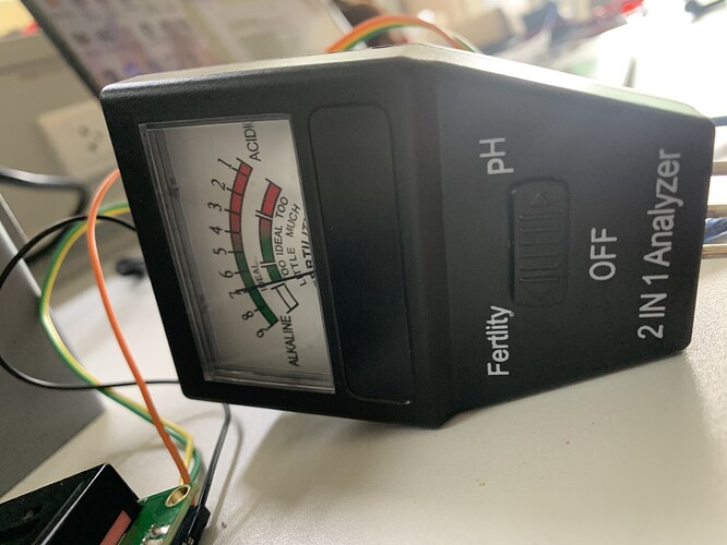

I tried to find the NPK code for the three-wire model as shown in this picture and found this code. I fixed it and then tried to upload the code to the board. What happened was that it displayed the values ​​on the LCD screen normally, but the values ​​kept going up and down and not staying still. Is this normal? Or what should I do to display the results on the screen?
LCD
  • = 5V
  • = GND
    SDA = P21
    SCL = P22
NPK
  • = 3.3V
  • = GND
    Signal = P34
This code

Please post full schematics.
Where did you take this sketch? How did you connect to sensor?
These 'things' should be using an 'ac waveform' to measure between the two electrodes, so if you are reading the voltage on one electrode it is normal that you see a not steady value.
P.S.
add only that the measurement from these sensor can't be considered reliable
Is the "screen" the "meter" on the analyzer with "alkaline/acidic"?
I'm sorry, I'm not good at English and confused. What I want to communicate is (I can connect many modules to the code and display the results). But what I'm stuck on is the npk sensor that I show in the picture above. I can display the measured value on the LCD. But the measured value is very messy. For example, if I leave it alone, the measured value will still swing and not come. It's all messed up!!! But what I noticed is that on the screen of the NPK sensor, the needle that points to the values ​​​​is still there and does not change the value. While the LCD screen, the value of NPK is all messed up!!! "Simply put, how can I display the correct value?"
Additional... I tried using a multimeter to measure the DC voltage coming out of the sensor. What I found was that there was normal power.
Is the sensor broken or is it my fault?
I am very new to this content, can you explain how I can connect the NPK sensor to the ESP32 so that I can get the correct values ​​displayed on the LCD?
The NPK sensor probably never "worked" and will never work. Not your fault. You did nothing to make it fail.

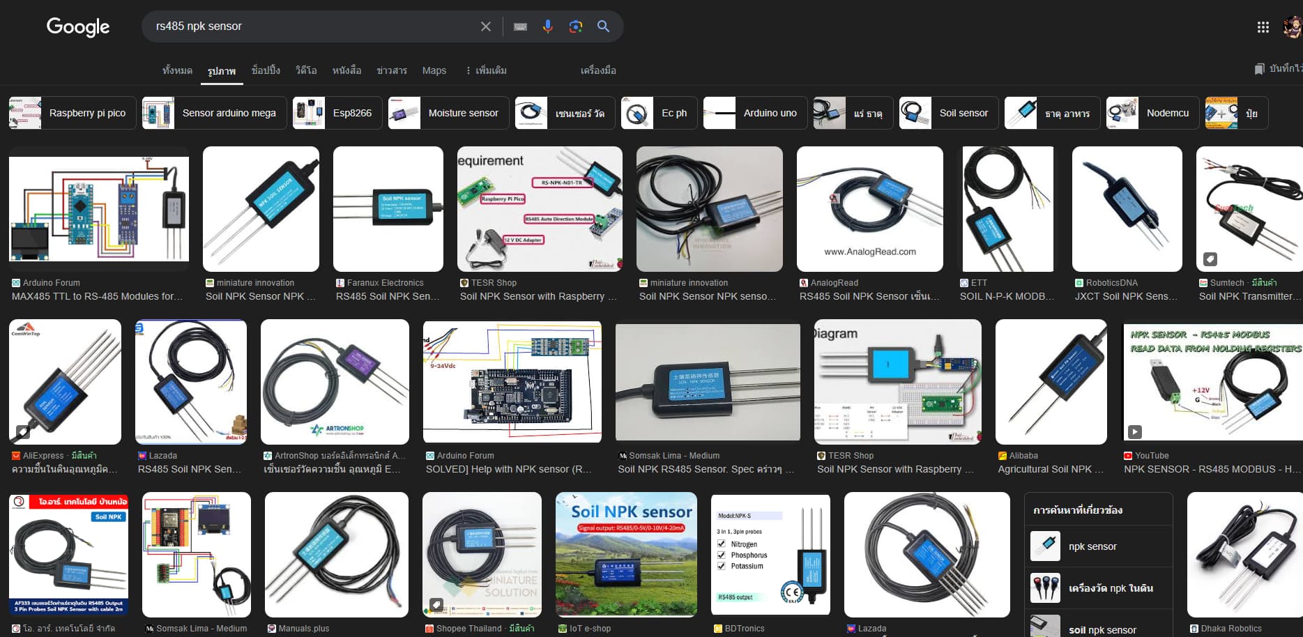

If I change the sensor to the model in this picture, will it be easier to use? Because when I search for information, I mostly find this model.
The chemists on this forum seem to be saying: You can not measure Nitrogen, Phosphorus and Potassium content in soil with an electrical probe. The numbers are generated and fake. None are good. I trust two Arduino content makers: RandomNerdTutorials and DroneBotWorkshop. Neither cover the NPK.
If you must use the probe... fine ONE of the tines (pointy things) that can sense moisture (higher conductivity) and just use that data and make up what the data mean.

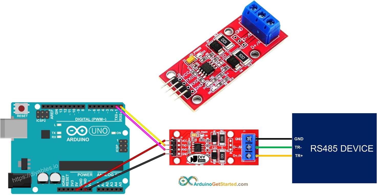

***In my understanding, I can connect in this order, right?
(NPK sensor -> RS485 Module -> Esp32 -> code) In this order, do I understand correctly?
The RS485 is a communications module. If the sensor has a RS485, and you follow a good tutorial, you should be able to receive the sensor data. Try this one:
