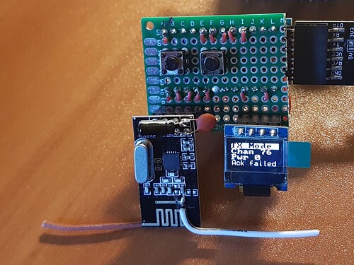

I created a rig for optimizing the range of your nRF24 devices and wrote a blog post about it:
It's easy to put together and I share the schematic and software

Thanks for sharing.
I have a had a look at your link but I could not see any info about the distances over which you got your nRF24s to work.
I have had a pair of the low-power units (with PCB antennas) working at 110m outdoors with clear line of sight. My test was poorly designed so I could tell if it was working at a longer range ![]()
...R

Good point - I figured people would find out for themselves, but it is useful to see what I got. I'll share some of my results.

I added my results. I haven't done exhaustive, clear line of sight testing. I'm interested in how well it works in a busy/noisy indoor environment.
