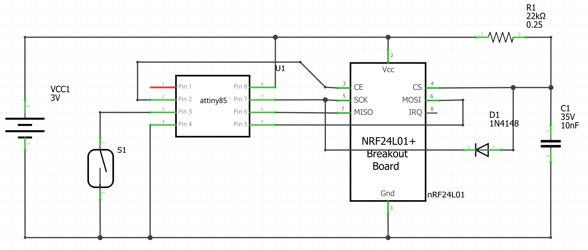

Hi, I'm building a few battery powered sensors based on the ATtiny85V (the V chip is somewhat slower and works at lower voltages than the regular ATtiny85) and the nRF24L01. I need one GPIO pin for a reed switch, the rest can be used for the SPI protocol to drive the nRF24L01. Because it's battery powered I need it to be as low power as possible. I stumbled across the 3-pin solution where two pins are free for other purposes, but because the CE pin is tied high it uses a lot more power. I then found the 4-pin solution below:
                           PB5  1|o   |8  Vcc --- nRF24L01  VCC, pin2 -----------------x--|<|-- 5V
    nRF24L01  CE, pin3 --- PB3  2|    |7  PB2 --- nRF24L01  SCK, pin5 --|<|---x-[22k]--|  LED
                   NC      PB4  3|    |6  PB1 --- nRF24L01 MOSI, pin7  1n4148 |
    nRF24L01 GND, pin1 -x- GND  4|    |5  PB0 --- nRF24L01 MISO, pin6         |
                        |-----------------------------------------------||----x-- nRF24L01 CSN, pin4
                                                                       10nF
My problem is that neither the 3-pin nor the 4-pin solution works. When I connect all 5 pins as in the RF24 example everything works but no pins are free for the reed switch. An LED connected to ATtiny pin 3 (CE) blinks in a rhythm and the data packets get sent as they should. When I try to wire up the CSN pin as above, using the capacitor, diode, and resistor, the LED on pin 3 stays on constantly and no packets get sent.
Below is my Fritzing schematic:
Two possible alternatives would be to use the ATtiny84V which has more GPIO pins anyway, or to use the RST pin as GPIO, but neither of these are optimal in my opinion.

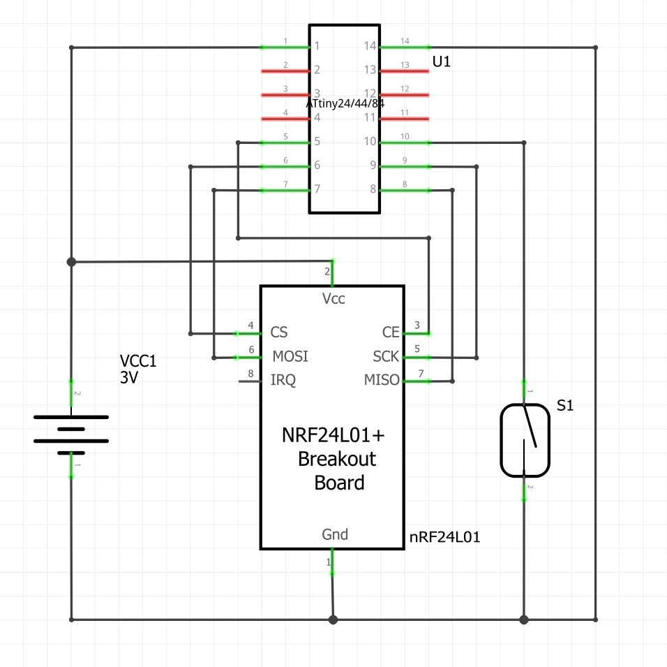

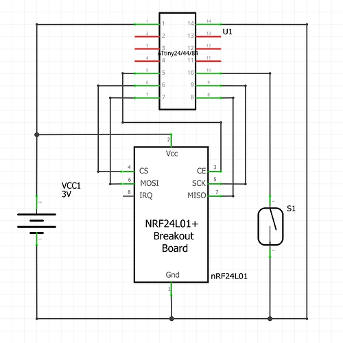

I made a quick schematic that accomodates the ATtiny84:
