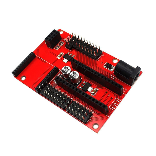

There are very cheap boards for the Nano that feature a socket for the NRF and a 3.3V regulator,
they come in handy for test.
Nano 328P IO Wireless Sensor Expansion Board for XBEE and NRF24L01 Socket €1.33
