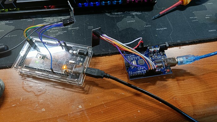

Hi, I am trying to communicate between two nRF24L01 modules. One is connected to mega 2560 and second to UNO. The problem is, that I get " No radio found " ==> no answer. My code and circuit:

Do you have capacitors on the radio supplies?
Make sure the rf24 power supply can provide enough current. This is especially true for the high power (external antenna) modules. I use homemade adapters like these. They are powered by 5V and have a 3.3V regulator on the board. Robin2 also has suggested trying with a 2 AA cell battery pack.
No, but I've tried it with them before, and it was the same. I used 10-50 µF (I can't remember now).
You can't do this in your receiver code loop(). You'll get 1000s of lines to the serial console during slight pauses in transmission.
Why do you only want 5 retries?
There is a radio.stopListening(); missing in the transmitter setup.
The 3.3V from Arduinos is rarely strong enough to make the NRFs work,
a capacitor can help, a solid 3.3V supply works best.

I tried it with external power supply, but it also didn't communicate.
What exactly is the "external" power supply and how did you have it connected?
Here:
I was also thinking about wifi, cannot be this the problem?
Can somebody help me?
Please post your latest code and show what messages appear from it on the serial console.
