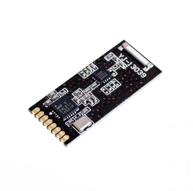

I have noticed something strange about these NRF's though. For these tests I have been using the standard modules, but I have also bought the PA+LNA kind as well. When I switch in the transmitter NRF for an upgraded one, everything works fine as it should. When I switch out the receiver NRF for the upgraded one, it stops working unless I put the setting to 2MPBS or have it set to 250KBPS and touch the antenna with my finger.
What is going on here? Are their consequences to using the PA+LNA version of the module?
The high power modules don't work well when too close, specifically when using
 radio.setPALevel(RF24_PA_MAX);
You could try lower settings.

Thanks for all the help! Lowering the power level at close range did give me stable data. I do have one last question though. Is it possible with the NRF's to detect when the module is "far" or "close" and switch the PA level based on the distance.
I did a little math and I do not think using the differences in delay would work out. At the speed of light, a transmission would take only 3.33 nanoseconds to reach the NRF from 1 meter away. From 100 meters away it would take 333 nanoseconds. I do not believe the Arduino is nearly fast enough to measure the differences in these delays. Among the other issues presented with this method.
So is there another way to do it? Is it possible for the NRF to judge how powerful the incoming transmission is and change its power level accordingly?
One could send packets and measure the ratio of fails under different settings. You have no access to any reception strength values AFAIK.
But basically I have no answer to your question.
