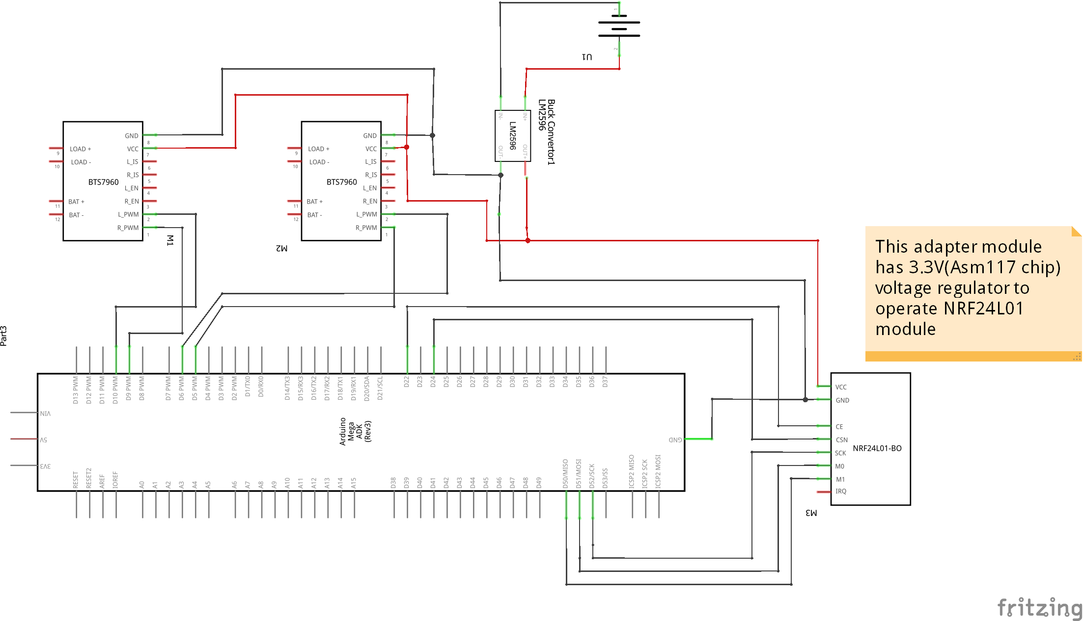

I have use adapter which has 3.3V voltage regulator to stabilize the power in NRF module. NRF24L01 Module connects with Arduino via MOSI, MISO & SCK pins. I also use NRF24L01 Module as transmitter & in that end I have used Arduino Nano. I don't have any problem in transmitting end. But in receiving end I face problem after running some time. Arduino Mega's (Atmega2560) Chip got burnt. I have control 2 BTS7960 motor driver to control 895 gear motor according to the signal received via NRF24L01.
2 Arduino Chip got burnt. 1st time Arduino Due got burnt in that case I have used SPI pin headers to connect the MOSI, MISO & SCK pins & in Arduino Mega I have used digital pins (51,50 & 52 ) accordingly.
Help us debugging the problem please.

Please post a schematic of your circuits
I am not sure that you will understand my bad drawing sorry for that
Understanding might be possible, if that were a schematic. Please try again. While you're at it, read:

I have updated the diagram
does it understandable now?
Is that the whole thing? Is there anything else connected to Mega's 5V, 3.3V? I see nothing untoward on your drawing, unless the NRF or BTS modules must only have 3.3V signals, and even there, I would expect that those modules might be damaged by a 5V signal from the Mega, but I wouldn't expect the Mega to suffer damage. Something is missing here.
What's powering the Mega, USB?
I forgot to add 5V connection in the mega
I have connected 5V from buck module into 5V pin of arduino mega
I found in the datasheet that BTS7960 module works fine in 5V input
are you sure that i have to supply 3.3V in BTS7960 module?

I have used 5S (19.5V) to powerup the motors 895 with gear box. It can handle upto 90 KG-cm torque. According to datasheet it might draw high current like 20-25A & in Stall upto 30-35A ( according to datasheet not measured by me in practical, It might vary as it is Chinese manufactured motors! ). From that 5S battery I have used step down buck module to regulate voltage to 5V & supply it to BTS7960 motor driver module to powerup the ICs as well as Arduino Mega 2560, & NRF24L01 adapter module.
After running some time my Arduino chip became hot & i think some portion of it might be burnt as I am unable to upload new code but existing code is still working!

All I can see at this point is that your buck converter is misbehaving. Have you tested it under various load conditions?
