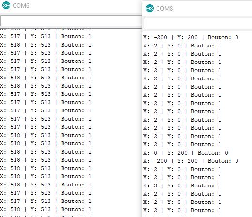

Here below a screen shot of my 2 Monitor each lines Tx in front of Rx :
Please make your image visible in your Post. See this Simple Image Posting Guide

did it ! thanks for the help link

Based on your comments at the top of Reply #6 I had assumed that the image would be showing the output from my Tutorial programs.
Now I'm wondering if this "i copy again your SimpleRX and Tx and change the txIntervalMillis to 100 and seems to be good" means that there were no errors when running my Tutorial programs. If so then the error you are seeing with your programs is somewhere in your software and not in the nRF24s
...R

Yes ! It seems to and this is my best hope ... but what can be the mistakes in my code !?
