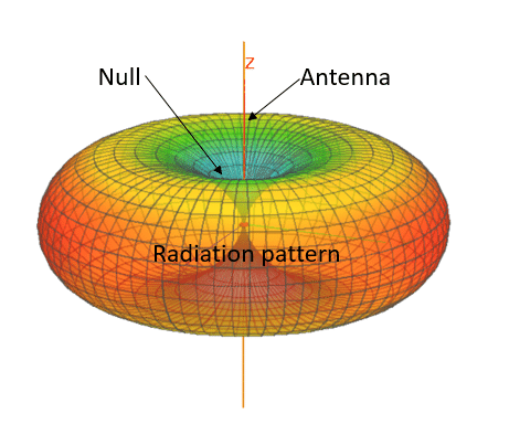

Are both antennas in the same direction?
Either both vertical or both horizontal, perpendicular to the direction of radiowave travel?
Like this:

**Author:** ![build\_1971](https://dub1.discourse-cdn.com/arduino/user_avatar/forum.arduino.cc/build_1971/32/689930_2.png) [@build\_1971](https://forum.arduino.cc/u/build_1971)\
**Post date:** [December 20, 2022, 7:18pm UTC](https://forum.arduino.cc/t/nrf24l01-not-1km/1067633/14 "2022-12-20T19:18:11Z")
</div>
![](https://europe1.discourse-cdn.com/arduino/original/4X/4/1/b/41be4e22e4281ad7a511746344279d1b50cef2ee.png)
As you can see, virtually no radiation leaves in the direction where the antenna is pointing...
If you have one vertical and the other horizontal, you will still not receive much as the polarization is wrong.
So, yes this can make a huge difference.

A side not to the image. That is for a true vertical dipole. The NRF antenna is just 1/2 of that dipole. The board and wiring make up the other half. Wonder if a true radiation pattern has been published for an NRF with external antenna?

Here is a monopole pattern
> **[Monopole Antenna](https://www.antenna-theory.com/antennas/monopole.php)**
> Monopole antennas are presented. Particularly, the monopole antenna is described in relation to a conducting ground plane and analyzed with image theory as a regular dipole antenna.
