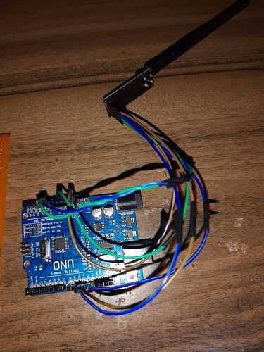

> [@KASSIMSAMJI](#):
> precious power from the batteries get wasted here,
The same batteries are connected to L289N for motors that require this much voltage.
> [@Grumpy\_Mike](#):
> What sort of antenna is it half wave or quarter wave?
I am not sure how to get that info tbh.
> [@Grumpy\_Mike](#):
> Has it got a decent ground plain?
> What about the material round the RX and TX? Any metal or conducting surfaces. All these affect the real performance.
I didn't understand what ground plain mean tbh :\<
You can have a look at the photos below
> [@groundFungus](#):
> I use homemade versions of these adapters
Homemade?
Is it just a regulator that's connected to 5v pin in Arduino?
> [@the\_3d6](#):
> so anything below 300 mA is not adequate - and at 300 mA it should be well within operation range, so I'd use something with at least 500 mA rating)
Thanks for the info \<3
> [@Wawa](#):
> I still think 150mA from an Uno should be ok
I have tested the MAX settings today and the transmission went farther than before as I have expected.
But for some reason when I was getting farther from the receiver, the receiver needed a little while to actually catch up and understand that the transmitter has gotten farther than before.
Which means the turn on and offs of the light got delayed out for some seconds before the light has turned on again.
After a few seconds the light turn on and off in time.
This thing kept happening as I got further.
Therefore I think that the solution to this is to give the appropriate current through the 5v pin and through the adapter as a lot of users have said.
> [@Railroader](#):
> Schematics showing how the devices are powered would be good to look into.
> [@alto777](#):
> We ask for a real schematic, even if you just draw it with a pencil and shoot a picture of it.
> [@KASSIMSAMJI](#):
> also show us your schematic please (or/and picture of your setup?)

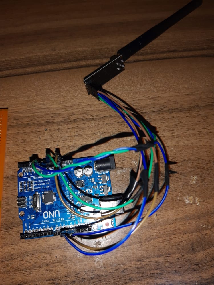

Here are the photos of the transmitter and receiver.
 ![WhatsApp Image 2022-12-21 at 6.01.02 PM](https://europe1.discourse-cdn.com/arduino/original/4X/7/1/a/71a75960bfa98973a839ef773ccc765ad0a94c68.jpeg)
 ![WhatsApp Image 2022-12-21 at 6.01.02 PM(1)](https://europe1.discourse-cdn.com/arduino/original/4X/9/c/9/9c91b4577b883a3514c56d9bbb98f3a076e719e6.jpeg)
The pink highlight is the 3.3V connected directly, while the green highlight is GND connected to 2 joysticks and 4 buttons and the NRF
 ![1](https://europe1.discourse-cdn.com/arduino/original/4X/8/3/b/83b9824a1f270fc2a884c7e338ddf45906303aba.jpeg)

Now, I wonder why I never dissected one of those rubber covered router antennas. I wonder if I have one in the junk boxes in the loft?

470 uF tantalum (and that's important - not electrolytic aluminium one) would work here indeed, most likely it will be fine even with Arduino's 3.3V - but not less than that. From the shape of that impulse I don't think that 100 uF would suffice, and I have doubts about 200 (although 200+ is worth a shot if OP has one at hand)

If that was ordinary nRF24 without PA then even 10 uF would work fine there.
You can estimate the necessary capacitance from several points, one is stored energy:
E=C \* V^2/2
On the other hand, energy is power \* time: E=I \* V \* t
From that image in that discussion I've linked, we can roughly estimate energy required for TX event as 0.2A \* 3.3V \* 0.8ms ~= 0.5 \* 10^-3 J
If we want all that energy to come from capacitor, we need to take difference of capacitor voltage before and after the event:
dE = C/2 \* (V1^2-V2^2)
And here we can put restriction: we want voltage on the capacitor not to drop too much. Let's say we want it to be 3.0V after the TX event. Then:
0.5 \* 10^-3J = C/2 \* (3.3^2-3.0^2)
0.5 \* 10^-3J=C \* 0.945V^2
C=0.53 \* 10^-3F = 530 uF
But also a large part of that energy would be supplied by still working 3.3V LDO, so with 470 uF we likely we'll get to ~3.15-3.2V at the end, which is close enough to not impair the transmission
\*I'm using V as voltage at first, and as Volt unit later, hope it's clear enough where which case is

> [@di\_g7](#):
In telecommunication, a _ground plane_ is a flat or nearly flat horizontal conducting surface that serves as part of an antenna.
This is from [Ground plane - Wikipedia](https://en.wikipedia.org/wiki/Ground_plane)
I can see from your photograph that you haven't. That will improve the performance if you fit one on both antenna.
