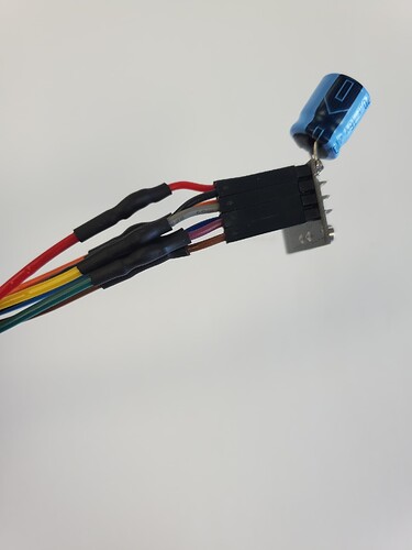

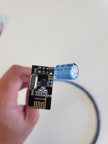

I've been attempting to get a pair of nRF24L01 modules working with Arduino Unos, but with no luck.
 ![20240710_094623](https://europe1.discourse-cdn.com/arduino/original/4X/5/8/e/58e3607ba2bcbd88ed73c7cdf8137224e2f5beb1.jpeg)
 ![20240710_094632](https://europe1.discourse-cdn.com/arduino/original/4X/6/5/b/65b92aea432cdac857c45898c60c932f6e8ee557.jpeg)
 ![20240710_094711](https://europe1.discourse-cdn.com/arduino/original/4X/3/3/5/3357cdddec5bb0da9cfcfaeb5970e349667d7c3e.jpeg)
 ![20240710_094730](https://europe1.discourse-cdn.com/arduino/original/4X/2/9/c/29c161484cba900a6e094e4c1b09ace5dc89cf18.jpeg)
note the yellow and green wires are connected to grey and purple wires respectively
 ![20240710_094742](https://europe1.discourse-cdn.com/arduino/original/4X/e/4/9/e4935922c498bc700b7cb9830c9304a78ebbbfad.jpeg)
Both pairs of Unos and nRF24L01 modules are wired the same way. I am bringing 5v to the Unos through the VIN and 3.3v to the nRF24L01 modules. I am using a voltage converter to obtain the 3.3v (picture shows 3.\_4 due to camera not capturing the output, but it reads 3.34 in person).
The 2 set-ups are running off two separate computers, approximately 15 meters apart.
I have version 1.4.9 of the RF24 library installed through the library manager. I attempted the example sketches provided, but could not get them working.
Doing some digging, I keep seeing [this](https://forum.arduino.cc/t/simple-nrf24l01-2-4ghz-transceiver-demo/405123) tutorial. I uploaded the "SimpleTx.ino" and "SimpleRx.ino" sketches to the Arduinos.

I tried uninstalling version 1.4.9 and installed version 1.1.7.
I tried adding a 470uf capacitor to the nRF24L01 modules.
The program output is the same regardless of which library version I use and with or without the capacitor.
I've tried switching witch module is receiver and which is transmitter. I've tried different Arduinos.
Any and all suggestions would be greatly appreciated.
Thank you.

> <https://github.com/nRF24/RF24/blob/master/COMMON_ISSUES.md>
As described above, the radio modules (notably the PA+LNA versions) are reliant on a stable power source. While these modules may work with a poor power supply, they often lose packets or fail to receive as many as a module with a better power source. Moreover, this can sometimes be seen in odd ways such as the radio module working better when touched. This again is likely a power stability issue because the radio module is missing a capacitor (a commonly neglected expense on behalf of the module's manufacturer).
Add capacitor(s) close to the VCC and GND pins of the radio. Typically, 10uF is enough. Depending upon your circuit's layout, differences in capacitors' electrolytic properties can be seen, such that a low ESR (Equivalent Series Resistance) rated capacitor is desirable.
