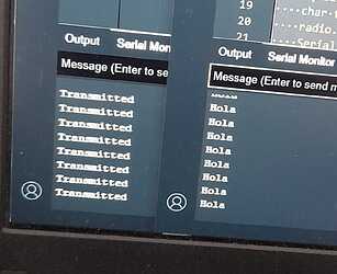

Hello! So my nRF24L01 modules suddenly work and suddenly don't. Same code. Just by simply moving it, it stops working and suddenly it does after rewiring/reconnecting/moving and such. What is causing this issue? I have been trying to fix this for a month now.
I attached images of my setup. I tried using the Breakout board for this module and without it (changed VCC to 3.3v without board). I am supplying 5v using an Arduino Uno, tried batteries and no difference. Even changed to smaller RF24. The picture in the left is when i changed which is which Rx and Tx. What i am trying to say is there is no consistency on when it works and when it doesn't. Just but re-plugging them without moving also causes receiver to stop working.

Use an external power source for the radios, the Nano does not have enough excess current to power them properly.
I have used an external source for the problem above. Same problem persists.
Posting pictures that show that would help but also posting an annotated schematic would help a lot more. It is possible having the antennas that close will cause all types of problems even to the point of damaging the receiver.
I kept them distant before and had same issue.
After a few more tries i found the voltage was lacking due to a mistake on my part. The voltage regulator has a 1.1V drop so had to supply it directly from Arduino nano. I used breadboard to supply from a different source before but that lost voltage somewhere? Also distant caused the issue definetely.
My mistakes:
  • Lack of proper power supply
  • Distance too close (at least a meter gap to work)
  • Wiring had issues
