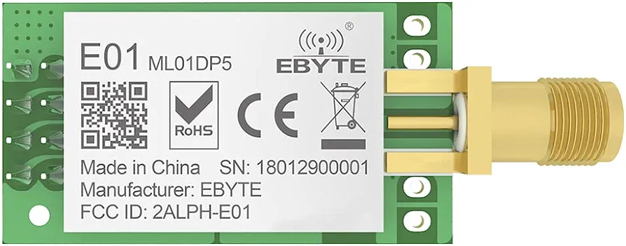

Hi, I'm going to get a RC controller for my new model airplane, this time, I thought it would be fun to make one of those Arduino based transmitter/receivers using this version of NRF24L01 from cdebyte with a promised maximum range of 2.5km in optimal conditions, and learn one or two things. me? I only need it to be able to respond at a distance of 500 meters, so that's why I'm using the most powerful NRF24L01 I can find in my country, because the cheaper Chinese clones here are said not to have any more range than 150m. So here are my questions:
  1. Let's say this thing can work in a maximum range of 600m at the ground level, what's the altitude at which it will respond without any issues? I know it depends on many things, but I need to know if it can go as high as, say, 30 meters.
  2. Considering I have no legal issues, can I use two 8dbi antennas for the two modules? How will that compare to a 2dbi antenna? Is the difference significant?
  3. For the maximum range, should I use two modules of the same model? Or can I use a powerful one like this one for the transmitter and a weaker Chinese copy for the receiver?

With a sensitive receiver maybe 500 meters. Altitude only helps.
I am assuming one on each end, no problem if they are compatible with the modules.
That would be a good starting place but you probably could use the cheaper one if you get enough distance from it.
Be sure to use a separate power source for the radios, the Arduinos have problems supplying power.
8dBi vertical antennas will probably be directional in the vertical sense. With both antennas vertical this is not normally a problem.
However an RC plane can climb or descend at an angle so the remote antenna is no longer at the optimum reception angle and you can loose control.

Just use standard 2dBi antennas.
If you want a more responsive range then use a longer range comms radio such as LoRa.
