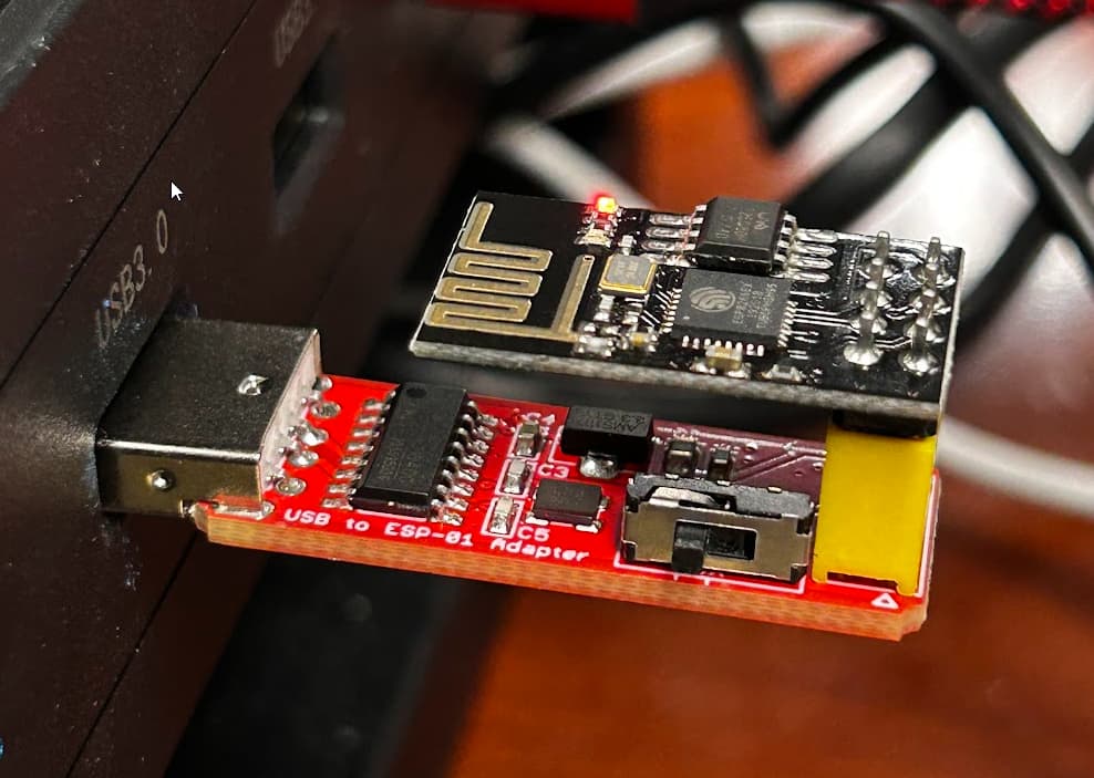

Currently, I have an older ESP8266 plugged into a handy [USB to ESP-01](https://www.amazon.com/ESP-01S-Programmer-Adapter-Wireless-4-5-5-5V/dp/B07V556Q82/ref=cm_cr_arp_d_product_top?ie=UTF8) adapter.
 ![8266](https://europe1.discourse-cdn.com/arduino/original/4X/9/3/d/93def1586f489e959d431334d28161743c6fd143.jpeg)
I uploaded a simple sketch (below) to retrieve Time using NTPClient:

Notice that in no way do I establish _any_ kind of IP connection in the code, yet when I upload the sketch, unplug the adapter and plug it back in to run the sketch, I get working results in the Serial monitor:
 ![8266-2](https://europe1.discourse-cdn.com/arduino/original/4X/8/a/1/8a1ddbb373b49c36fa6b288278058973a843650f.png)
I would expect my code to fail at this point, but I can only surmise that the USB to ESP-01 adapter provides a working connection to the 8266 that is plugged into it. If that case, how can I determine (from within the sketch) what the IP address might be?

**Author:** ![noiasca](https://dub1.discourse-cdn.com/arduino/user_avatar/forum.arduino.cc/noiasca/32/1126910_2.png) [@noiasca](https://forum.arduino.cc/u/noiasca)\
**Post date:** [June 27, 2025, 1:50pm UTC](https://forum.arduino.cc/t/ntpclient-library-is-working-without-any-code-to-establish-a-network-connection/1392191/6 "2025-06-27T13:50:36Z")
</div>
> [@NoThatOtherGuy](#):
> I have not established
This is done by the ESP in the background - may be due to a previous sketch you had on your ESP before this outdated NTP sketch.

**Author:** ![J-M-L](https://dub1.discourse-cdn.com/arduino/user_avatar/forum.arduino.cc/j-m-l/32/766245_2.png) [@J-M-L](https://forum.arduino.cc/u/J-M-L)\
**Post date:** [June 28, 2025, 7:11am UTC](https://forum.arduino.cc/t/ntpclient-library-is-working-without-any-code-to-establish-a-network-connection/1392191/7 "2025-06-28T07:11:26Z")
</div>
It remembers an old connection.
If you Call `WiFi.disconnect(true);` in the setup() that will clear saved credentials.
