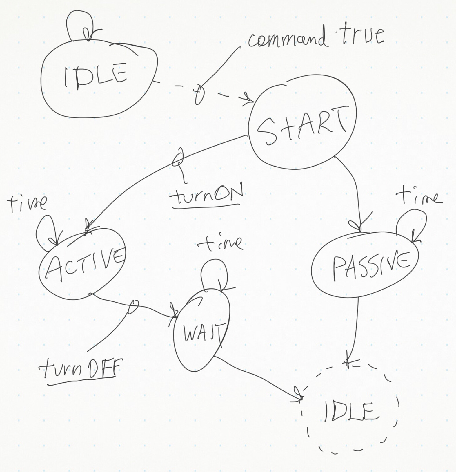

I found an opening in your sketch posted in #19 where an independent event handler can be inserted.
Where you call display.display() is where I initiate or advance an event. I use a finite state machine to select timing and march out the event steps.
I could not build your sketch, so I stripped it of everything, including its pride, and ran it with the serial monitor.
All it is meant to do is show how an opportunity to advance a process can be inserted into the loop to more or less handle some other task. Watch it here, drag up the serial monitor window to see more lines of the output:
Wokwi_badge Event FSM Demo!
Because life is too short, I arranged for faster minutes and used shorter periods all over the place. Figure that out.
The only tricky trick is that the FSM is designed to be started externally, and it reports about whether it is finished or not:
  if (!eventHandler(0))  // servic kick some life into it.
    eventHandler(1);     //
If calling the FSM for advancing the event progress says the machine is not doing an event just now, a second call immediately launches the next event.
The eventHandler() always takes the full event period. Sometimes it turns ON something for some part of that.
Run the sim and marvel just watch it sequencing. Then read the code. Then read the code. The event FSM is the last function. I larded it vigorously with print statements - I like to see why what is happening when.

enum {IDLE, StART, ACTIVE, PASSIVE, WAITING,};
// call with true to launch an event.
// call with false to move an event along its timeline
// returns true if the machine is busy with a previously launched event
unsigned char eventHandler(unsigned char command)
  static unsigned char state;
  static unsigned long eventStartTime;
  static unsigned int eventLivePeriod;
  unsigned long now = millis();
// newly event?
  if (command) {
    state = StART;
    return 1;   // we busy
  switch (state) {
  case IDLE :
  case StART :
    eventStartTime = now;
    eventLivePeriod = random(shortLife, longLife);
    state = random(1000) > 500 ? ACTIVE : PASSIVE;
    Serial.print(millis());
    Serial.print(" launching a ");
    Serial.print(state == ACTIVE ? "ACTIVE" : "PASSIVE");
    Serial.print(" event ");
    if (state == ACTIVE) {
      Serial.print(eventLivePeriod / 1000);
      Serial.print(" seconds ON");
    Serial.println();
  case ACTIVE :
    if (now - eventStartTime > eventLivePeriod) {
      Serial.println(" done with active period of the active event.");
      state = WAITING;
  case PASSIVE :
    if (now - eventStartTime > intervalPeriod) {
      Serial.println(" done with passive event.");
      state = IDLE;
  case WAITING :
      Serial.println(" all done with active event.");
      state = IDLE;
  return state != IDLE;  // we busy?

Your code is "friendly" in the sense that it does not block. So in theory at least you can add quite a bit of functionality before you run in to any real trouble. As long as no one blocks, either with delay() or with long loops that do not give back control to the loop() function.
After I stripped it down so I could run the logic, I just started hacking, as is my wont, to see if I could get some attention on a side task, to which side task I assigned the entire event mechanism.
You will or have seen that I added some printing here and there and used a few tricks to cut down on said printing.
There are some missing details - I did not code for the five minute startup no event period. I took no care at the end to stop events from happening.
There are no calls to delay(). I like to use just one call to millis(), at the top of the loop() function and use that everywhere, so everyone agrees on a standard time. Ppl will call this "currentMillis", I like the plainer now as a name for that variable.
I did not do that here either.

The crudely drawn state diagram below shows how the FSM which is eventHandler() functions. It is called 1000s of times a second, most of those times will do nothing more than decide it isn;t time to do anything.
Calling it with1 (true) bumps it off the IDLE state.
StART selects at random between passive and active launch. Launching a passive event moves to PASSIVE. Launching an active event chooses the ON time and moves to ACTIVE.
PASSIVE just waits out the entire event. ACTIVE sees the active time pass and moves to WAIT, which there waits out the rest of the event slot. Both then transition to IDLE and the machine is, well, idle.
I have found that some timings will end you up with the beeper on and/or the LED on, so you may have to have a kill() function you can call to clean up things left dangling.
If you don't want events handled, just don't call it, and call it no more when the logic moves to unlock the locked thing.

Wow, I was not even aware of the Finite State Machine (FSM). I thought you were accomplishing this using some form of interrupt handler. My mistake. Starting to do some research as some places say that the ESP32 may support it but not the ESP8266. I have some reading/testing to do to ensure that FSM is supported on the platform I'm using. If I found that I was constrained, I would move up to the ESP32 (which appears to support it at first glance) and has more memory. I do not see processing being my constraint over memory and that is why I was looking to strip out all the unneeded Serial.print instructions from the code after tested the various functions. I'm going to have a look at any tutorial on FSM and get to know it better. Seems to be a really neat tool in the toolbox.
a finite state-machine or short state-machine is pure software and completely indepedant of hardware.
For any type of microcontroller that has more than 10 bytes of RAM a state-machine can be coded
one example how it works is here
@StefanL38 and @alto777 I have been doing my research along with the links provided on Finite State Machines (FSM) and how they work. It is quite an ingenuous was of doing non-blocking code and "multitasking" in near real-time (in comparison to human time. I can see now how breaking down the various states (idle, active event, relay during active event, etc.) as alto777 did in the diagram (Thank you as that helped my solidify things more) and then what events occur to move to the next state. Again, I like the non-blocking as I can then use the idle time to update the display with data about what is occurring. I have been trying to really think thought the various states and potential additional states that the project would benefit from. I had reviewed a few people that leverage the Traffic Light to show the different states it can be in and even better one person that used the example of calling an elevator via the press of a button.
With this new insight and learning, I will dive into the code example you produced alto777 with a much better understanding and idea of the applications flow. hank you both for continuing to take me under your wing and guide me not only though the process but take my project to the next level where the code will be more mature and malleable.
