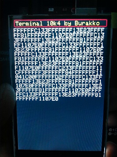

As everyone knows communication with Peugeot does not belong to easy. In my Peugeot Partner when I use the ELM327 I can read only one parameter. Why ??? I have to solve this problem. I built a terminal using Mega2560 + 3.5 LCD + L9637d. I connected to the line K between the ELM and the car. Using phone and applications ELM Terminal i sent Q to the ECU about RPM - but receives garbage .... why?
In the 5 foto see string - I separated the information - FFFFFFC133FFFFFFF13E23FFFFFF81FFFFFFF1107E0
appears every 2s.
in the 6 foto you see different srting because i ask ECU "RPM" - FFFFFFC233FFFFFFF11CFFFFFFF3FFFFFF84FFFFFFF11041C00FFFFFFD2

As I understood: The ELM327 can connect and initialize.
Then you are only able to read one PID. Which one and what is the response from your car?
Do you use Torque Light or something?
Via Bluetooth (BT Terminal or whatever), you should be able to send the following AT-commands:
