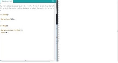

I used "the same" sample code that the sellers page in.** **But It doesnt work what I want to.
here`s the sample code.(Including comment)
plug infrared motion sensor on digital port 3. If signal is detected, digitalRead
will be high. Switch the resistor backward to adjust the sensitivity as you want.
Serial.println(digitalRead(3));
delay(100);
// end of the sample code.
When I click the serial monitor, "1" and "0" appears regularly.
How to use the Sensor? plz help..

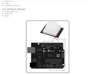

Can you provide a link to that page showing the diagram, it does not look right.

The fact is is outputting zeros and ones suggested the input is floating and that diagram looks like the input pin is connected to 5V.
http://eleparts.co.kr/EPX39C6X (This is the Korean page, but you can check the pin....)
Gravity: Arduino Infrared Motion Sensor - DFRobot (English page)
Thanks :slight_smile:
Sure it's not just detecting your movement? If it is, then it's working OK.
Thanks for the link. There seems to be a bit of ambiguity about the diagrams with respect to the digital pin out. The photographs do not exactly match the drawings to my mind.
Sadly the English on the links show poor skills from the translator:-
I would ask what resistor, where and what does switching a resistor backwards mean. It would imply swap the two leads of the resistor but that is just stupid so don't try it.
It does say:-
Power it up and wait 1-2 seconds for the sensor to get a snapshot of the still room.
So are you doing this? It has a wide coverage so be sure to point it away from you when you "calibrate" it.
Finally check that the wire to pin 3 is making good contact.
